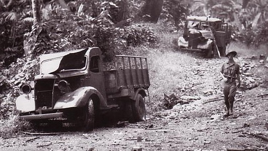

Default Recaptured Ex-Jap Chev trucks
Picture No 1
Finschhafen, New Guinea, 1943
Old 05-02-04, 07:06

The top photo...I assume that the characters on the frille are Japanese? 1941-on Chevrolet, probably a KNIL delivery originally but conjecting one of the GM Java-assembled trucks seized by the Japs and then re-captured.
The bottom two? 1937-8 Chevrolets, GM Java-assembled or just possibly GM Japana, Osaka.

Hi, Picture number 1 really looks like a ex-KNIL vehicle. This is the 4x2 type I was referring to in my last post. Is this a 160inch wheelbase MS?
I am not sure about the other trucks in the next pics. They could be ex-NEI. But KNIL military built trucks usually had no cab doors and no rear mudguards. But then again they could have been ex-civilian trucks.

The top pic # 1 appears to be a 1941 Model MS with the wooden cab? The # 2 and #3 front appear to be 1937-8 Chevrolets with a local cab, perhaps a 1940-41 rebuild by the Army?

About Pic #2 identification: I have seen several Dutch/Daf? produced vehicles (for the NEI) with similar cab style, more specifically the "Stage coach" type open sides. (see for instance the Wheel and Tracks issue on the DAF-GM connection...
Was it an imported truck?

I would have thought that the '37-38 Chevrolet was a chassis with flat-faced cowl, and CKD from Bloomfield Boxing Plant, New Jersey, with local assembly. The imported truck from Antwerpen would have the GM Continental design of steel cab.
