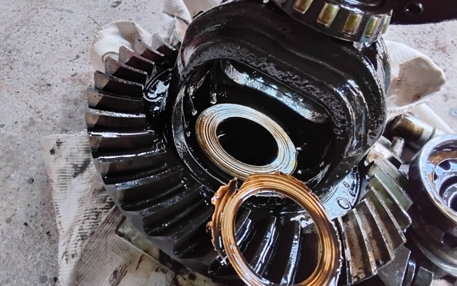

The diff carrier has some scoring where the side spider gear bronze washer has been turning. I tried a bodge repair and it worked out well. I used a stone and carefully ground the surface flat .
