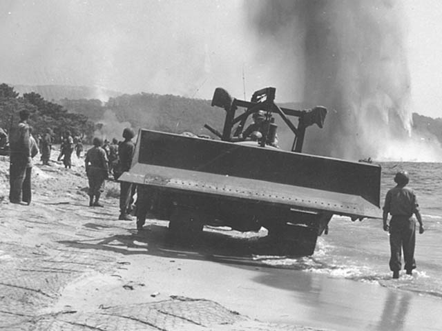

Been stooging arround a few websites of US engineers - found these two photos of what looks like Sommerfeld track on the South of France beaches
From http://www.dogfacesoldiers.org/
