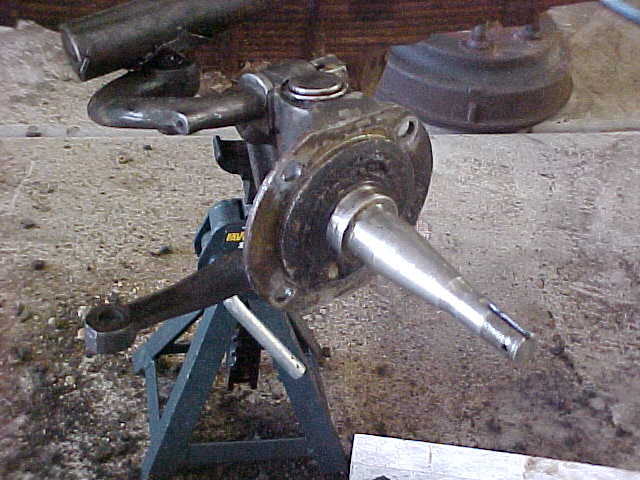

Yesterday and today we disassembled the front suspension. That involved:
Removed the hubs and bearings.
Removed the steering wheel, column and gear box.
Removed the steering arm and the connecting rod. (Had to use a puller on the steering arm!)
Removed the king pin retaining pins.
Removed the front axle.
What we didn't get done was removing the king pins. Those are stuck, stuck, stuck in the axle. Tomorrow will take the axle with spindles attached to a machine shop for removal. Will have them replace the king pins and bushings as well.
Am also stopping at a parts place and pick up all the parts needed to rebuild the brakes.
By the way, I'm missing the floor support bracket that's under the door on the driver's side; anybody out there have a spare one? (See the picture of the one I have.) I did contact Brian Asbury but he doesn't have it.
Hot again today (107 F) so we quit at 11 am.
Happy Canada Day!
Jim

Default Day 23
Today we concentrated on removing the front springs and the rear brakes, incuding the removal of the backing plates.
The front springs' shackle bolts, which are enclosed in the bushings, were worn to the extent that they as well as the brackets that hold the springs to the frame will need to be replaced. The front bracket which should have a simple slot looks like a keyhole!
We were unsuccessful yesterday in finding brake parts and are going to a brake specialty shop on Monday to see what they might be able to do for us.
Was surprised to find (and dismayed!) that the only brake part on the left rear side was the wheel cylinder. That's right! No shoes, no springs, no adjuster! Weird!
As for the right side, the entire brake system will filled with an oily gunk!
Have attached pictures of these two.
Got a call from the machine shop and the axle is ready. It took 18 tons of pressure to push out the king pins but now I have new bushings and pins! Will pick it up on Monday as well.
Temp reached 107 F so we stopped work at 1:30 pm today.
Jim
