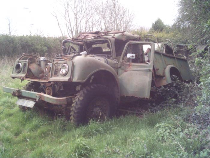

Default Gearbox and radiator
Hi - I hope this is OK, but I heard via the other forum that after a clear-out, Clive had a radiator and gearbox available very reasonably priced only about 35 miles from me. I even saw a picture, so I am hopping with excitement. My truck (02BK09) has no Rad at all and is missing the whole top plate/selector mechanism from the gearbox - it has been open for ages so probably shot anyway! - so these would get me closer to rolling under my own steam.
I messaged via the site but not sure if it got through or not -
I know that these may be sold already, but there was a possibility that if nobody wanted them the scrapman would get them!!
So I thought I would post on here.
Hi Clive, if these bits are still available I would jump in my car right now!
I sometimes don't read this forum for a few weeks at a time...so if anyone else is in touch with Clive please let him know that someone wants the stuff if it is still available. I can live with someone else having it but missing it to scrap would keep me awake at night (heck, I'm awake now - it's past midnight! I'm off to bed.)
Tom
Portsmouth, UK
07879 422701
023 92372 722
tom1087@hotmail.com
0051 2008 Apr 01Screen straighter.jpg   0002 2007 Apr 03 Wrecked Truck NSF.jpg
Humber-One-Ton Tom
