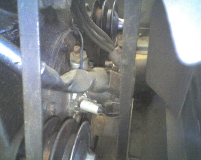

It was mentioned to run a 12 volt coil with a 12 volt system. Will this work with the points ignition (distributor)? I have also read that you need to use a 6 volt coil with a resistor to step the voltage down to 6. Can anyone shed some light on that question?
Also, are there any good electronic ignition conversions for the flathead distributor out there that anyone has tried?

A 12v resistor coil actually runs on about 8.6v, while the original Ford 6v coils have an ignition resistor and run on around 4.6v. Running a resistor coil without a resistor will burn out the points. Running a 6v coil in a 12v resistor system will give too much voltage at the points and burn them out quickly, and may even damage the coil. A points distributor will work fine irrespective of the operating voltage, provided the correct coil is used to prevent burnt points, ie 12v w/o resistor, 12v Res coil w/ resistor, 6v coil w/o resistor or 6v Res coil w/ resistor. Mention was made above to the coil adapter because that arrangement will give a wider range of coil choices.
There a couple of electronic conversions for the "Crab" style distributor (as well as whole new electronic dizzys), but I'm not aware of any for the "Diver's Helmet" style. The electronic units only work on 12v (not 6v), but there are also Hall Effect and LED triggered units that COULD be made to work on 6v if you were really keen.

Thanks for the response. I need a bit more help knowing what you mean by resistor coil. I guess, in effect, I want to upgrade (and simplify) my ignition as much as possible for the very fact that I am not an electrical expert and function and simplicity and reliability mean more to me than originality. For this reason, I am even considering upgrading my generator to the following internally regulated piece in order to eliminate the external regulator as being a potential problem:
http://www.powermastermotorsports.co...rGENbackLg.jpg
http://www.carparts.com/autoparts/It...D:100000357735
But, as an "electically challenged" tinkerer I am not sure what I would need to do about the coil. Are you saying that there are 12 volt coils that are internally resisted down to where they will work with the flathead points distributor? If so, can you give me a recommendation for the setup I have? It's still a positive ground but a 12v battery, the above generator, original 6v starter and factory distributor? I am not worried about any other 6v items as my lights, guages, etc. are all converted to 12v already.
In recognition of your closing comment, attached are some photos of the distributor that I have. Hope the pics are clear enough for you to tell what kind I have. The coil is (as you can see) remote and not integral as I have heard some mention.
Thanks so much for your help,
Ross
Old 04-02-09, 00:46
Your distributor will work on 12v and does not need to be "resisted down" to work with a 12v coil. Any coil you select does, however, need to be wired in an appropriate system with or without a resistor to match the coil. Examples of coils can be seen Here for Lucas. Speak to an Auto Parts shop and they can suggest a proper set up. A coil with resistor can provide better starting IF wired up correctly, but you might need an Auto Electrician's assistance to do that.
From what I can see of your distributor, it looks to be a British type fitted to Ford Pilot cars and Thames Trader trucks. Are you in the UK?

Actually, I am in Oklahoma USA. Just purchased this carrier. It was in Northern Illinois but I understand it had been in Wisconsin previously. I just picked it up over the weekend and was trying to size up what I had bought sight unseen. It would start 'okay' but not great but just didn't seem to have any power. I noted that it had a 12v battery and original 'looking' generator. Wasn't sure about regulator or coil. But, I noticed that after literally a minute of runtime that the coil was super hot. I checked the voltage at battery (which was around 12v) and at the coil which was, also, about 12 volts. I guessed that it was a 6v coil and wondered if it needed a resistor. Not finding one I just tried wiring one in and with the resistor the voltage at the coil dropped to 6 volts, the coil stopped being hot and the carrier runs totally different.
I think I may have fixed it. Replacing the coil would probably be a good idea still as I have no idea how old it is or how hot it's been. But, for right now it seems to be better.

1. No. its not the british distributor, its the third type dizzy(latest)and
2. its the capacitance of the condenser, that dictates whether your points burn out. the condenser needs to match the coil (what ever voltage it happens to be) If the capacitance of the condenser is too high, or too low (measured in micro farads) metal transfers from one contact to the other.Have you noticed how 6 volt systems seem to have large condensers, and 12volt systems, have small ones?
the main purpose of a resistor coil(or ballast resistor coil) is for ease of starting. for example a car that runs a 12volt system, with a ballast coil feeds its primary ignition system though the ballast resistor, reducing the voltage to around nine volts (essentially a 9 volt coil) When the key is in the start(cranking) position, the coil is fed directly with the full 12 volts, giving the spark a boost. when the key returns to the run position, the coil is once again fed 9 volts, having been dropped from 12volts, by the resistor.
