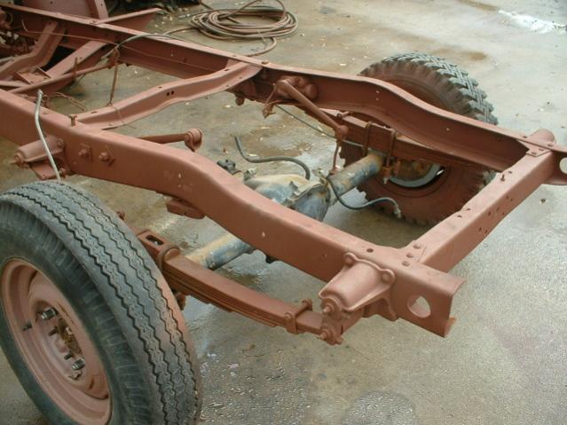

Thanks again! David
  #79
Old 12-02-09, 04:49
Join Date: Sep 2005
Location: Plano, Texas
Posts: 357
Default Slight C8 progress, and a question...
Hello,
Slow progress being made on the chassis of my C8 as I can find time, but any progress is better than none.
Front springs got sorted out, as they were cobbled together with no two leaves matching on either side except for the primaries. A set of partial rear spring packs from a 1/2 ton Dodge Weapon Carrier fit wonderfully.
Front knee action shocks were frozen solid! An hour or so with some fresh shock oil, and some not-too-gentle persuasion and they were good as new.
A pair of suitabe front axle stops were made from crusty 3/4 ton Dodge WC units with a little work on the bench grinder. The 65 year old rubber was like new just under the surface.
Had a question about the original arrangement of the rear axle stops: Was browsing photos of other C8's and noticed the one in the photo had cast or stamped brackets outboard of the frame for the rear axle stops,(circled in red). These align with the cast pieces on top of the rear springs that look like they should have the rubber stops installed on them also.
My C8 has brackets rivetted under the frame with the rubber stops, but also has holes in the frame for outboard brackets. My existing ones look useless, as the rear suspension would never be able to compress far enough for them to contact the rear axle.
So, my long-winded question is which type of arrangement would be correct for a C8?
Many Thanks, David

The correct bump stops at the rear are the ones bolted directly under the chassis as you have shown in the fourth photo
The correct ones for the front ones are as you have shown
The additional bracket on the rear of chassis in the 3rd photo is a ring-in and is only bolted on ( I know this because that c8 is the c8 i bought first and is sitting in my shed)
Have a good one
Andrew

Thanks a lot Andrew for the information! Looked today at a '41 civilian 1.5 ton Chev I have for parts, and it has the same bump stops mounted under the frame. Still an odd place to position them as the springs would have to almost bend backward for the rear axle housing to contact them.
Didn't realise that was your C8 in the photo I used. How's the restoration coming along?
Thanks again! David

Restoration hasn't begun on that one -That one is a major restoration project reserved for when i get a lot braver
A lot of rust and mis-matched components
It would be a massive bump required to hit those stops
Have a good one
