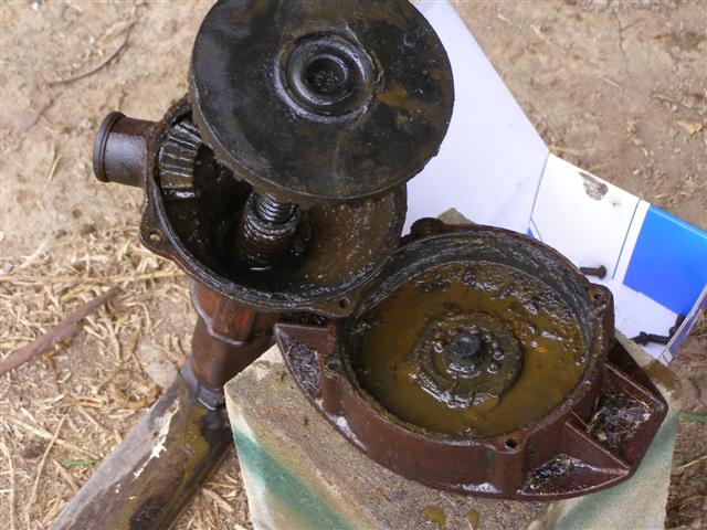

The penentrating oil finally loosened the screws and I got the jack in half today. It was full of water wich I have replaced with oil to soak until I get a chance for futher work.

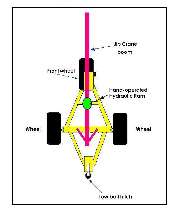

I only have a 28 horse power Yanmar 4wd which is too small to hang a jib off. I have a three point linkage jib crane and I am thinking about hanging it off a differential with wheels and mounting a triangle frame with a similar sized wheel hanging off the top of the triangle. Then using a hand operated hydraulic ram mounted on the triangle frame to lift the jib. At the back of the diff I would put a drawbar which hooks up to tow ball mounted on the front of the tractor. That way the weight of the load would be supported on three wheels and the tractor would just shift the whole rig around the paddock.
I want to be able to lift off the tray of my two trucks which both have motors that do not work at the moment and shift the trays into the paddock so I have access to the chassis and then use it to lift the cabs off too.
I will be using the thickest wall RHS to make it nice and strong. Do you think by looking at my sketch that my mobile jib would work? Nothing is drawn to scale just playing with the idea at the moment.
