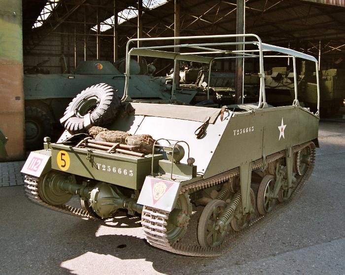

Here's some pictures of a nicely restored example:
Old 25-07-04, 12:06
T256663 is owned by the Tank Museum at Brussel. It was pictured at the Friends of the Tank Museum open day at their Kapellen depot, Saturday 19 June.
