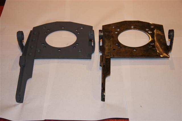

Hi All
Please find photos attached of the first aerial base folded and welded.
There are a couple of small issues to be ironed out but all in all I am happy with the result.
In the production run I will include the 4 rivets holding the handle to the top plate and the welding will be oxy and not tig. A couple of minor adjustments with the laser cutting of the sections and all will be in order.
On a sadder note, I am unable to work on the project for a couple of months as this Thursday I fly to Istanbul to start a driving holiday that will see me at the 65th D-day events. If any of you are attending the D-day events, please call in on our camp. Just ask for the mob of Australian ww2 vehicles camping with the MVT group. I'm driving a chev (blitz) cmp 4 x2 with 2 tone camo.
I will be back home on the 24th of June and will kick off again once back.
Sorry for this but I promise to confirm prices and availability once back.
Kind Regards
Nigel

Hi Again
I thought I would add some photos of each item
Nigel

It lookls like production is coming together nicely.

Your workmanship speaks for itself Nigel.
Please take your time and enjoy the Holiday.
Good things come to those who wait...

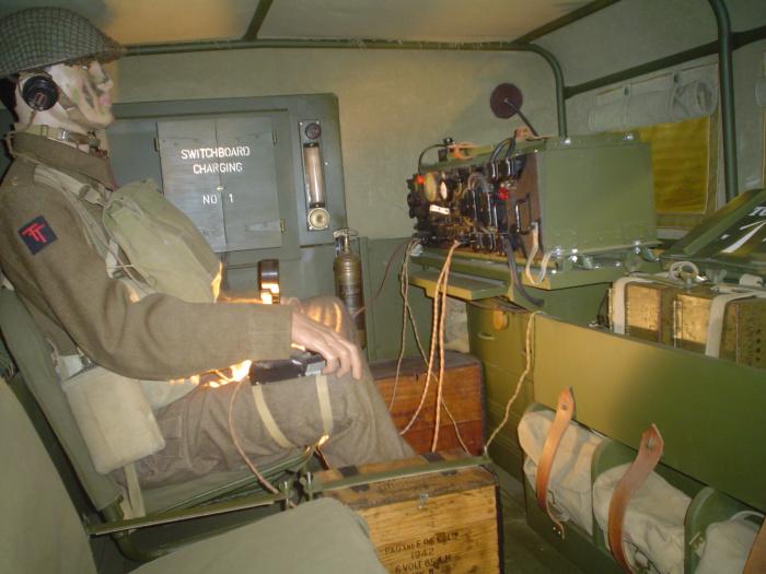

OK Mike. I hope it's alright to talk PU's on this forum, but at least it's related to the wireless theme. Enclosed a couple of pictures of my 11set station( Thanks again Mike) Manned as usual by my operator, Private Spoons.
Ron

Looking great Ron, I see you have gone to some trouble to 'get it correct' . re: the wooden battery boxes . Did you use my drawings ? I found those batteries out at Hughes, in Sydney rd , years ago. I realised what a rarity they are, 1942 dated lead/acid wireless batteries... and British ones as well.
The info is from the British 11 set manual

Bruce, Nice set..the vehicle mount frame is a rare item .. do you have the lid ? The numbers indicate a fairly low production run... maybe less than 1000 . The thermo couple meters come in HP and LP ...many of the LP ones are burnt out as people use them when the set is switched onto HP mode ( a whopping 4 watts ) . The Aust. sets have a larger diameter meter and plastic cover than the British sets ..not compatible.
The Aust. meter may fit your set..but hard to tell from the pic. I had many of the Aust. meters here . The covers are usually discoloured and scratched ..but I did see a box of new ones many years ago..
Would be interested in knowing what tubes the Canadian set has inside it .
BTW a friend here in Adelaide made up some of the 11 set mobile mount frames .. not 100% accurate but not bad.. Ron bought one for his PU .

Default Thanks Bruce
Anything you could do would be great.
And I agree, Geoff should consider a wireless forum (heck, maybe even include line equipment) so we don't have to hijack vehicle threads just to throw in pictures like this:
