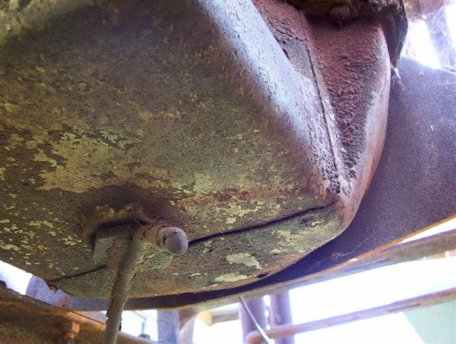

Alex McDougall
Join Date: Feb 2009
Posts: 200
Default A few sump types
See pics (first time hope it works) below for a few sump styles. Hope they help a little.
The Pics 1of2 and 2of2 are the same sump unfortunately can't get a better view and in shadow a bit. 1of2 is looking at the bottom near the rear (motor on its side of course). The rear shot shows the pinch starting around the left side and it progresses anticlockwise around to the right side - it's just that the shadow hides a section of it.
The other two are explained by the picture names.
I don't seem to have a shot of a sump with the square or rectangular access plate with the plug inserted.
So that seems like 4 styles of sump?
M3 Grant, Val, Ferrets, WM20, CMP's
BoltedPinchLip1of2.jpg   BoltedPinchLip2of2.jpg   IsThisBGCsump.jpg   InF15CMP.jpg
