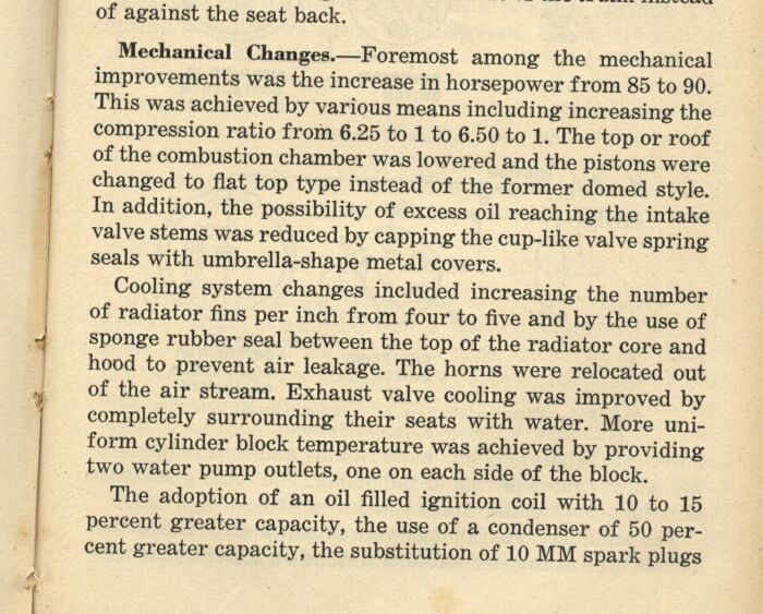

scan from the 1950 edition of the Victor Page book..I have both the Chev and Ford versions of this informative book. At just under 1000 pages ... much info .
The page is refering to the 1941 model changes ....

The book covers up to 1950 . It describes the introduction of hydraulic valve lifters on the 235 ci motor as fitted to the Powerglide auto transmission .
BTW the 216 first appeared in the 1937 models ... in the book, he refers to the 1935 206.8ci motor as the 'blue flame' motor. ( bore 3 5/16" )
