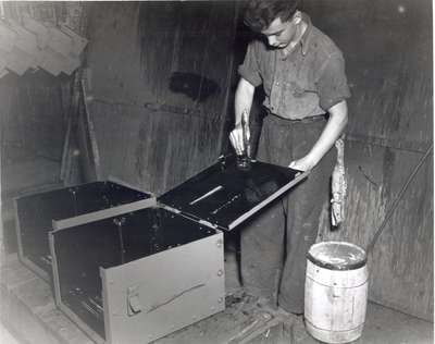

Hi, Interesting pictures from Ford Canada carrier production, confirming the battery box internal was painted with a rubberised black paint. A couple of others featuring instrument panel production and carrier box fabrication.

Kevin. Just wondering why you think it's rubber paint. I thought maybe it was the standard black primer used on a lot of stuff. Saying this, rubber paint makes sense for something housing batteries

Old 18-07-11, 01:20
kevin powles's Avatar
Join Date: May 2006
Location: united kingdom
Posts: 2,003
Default paint
Jordan, If you look at the battery box in the store room, the inside is clearly still in this gloss black finish, the guy painting is only painting the inside, also looking at shauns Ronson carrier (picture attached) there are remains of this paint. The rear plate the box attaches to was also painted as the remains can be seen in the picture.
I have used chlorinated rubber paint at work at it look just the same, I am guessing with the use of enclosed battery cells on charge you would not want a spark from the hydrogen gas and to reduce the risk of shorting out the battey you whould benefit from insulating the battery enclosure.
kevin.
