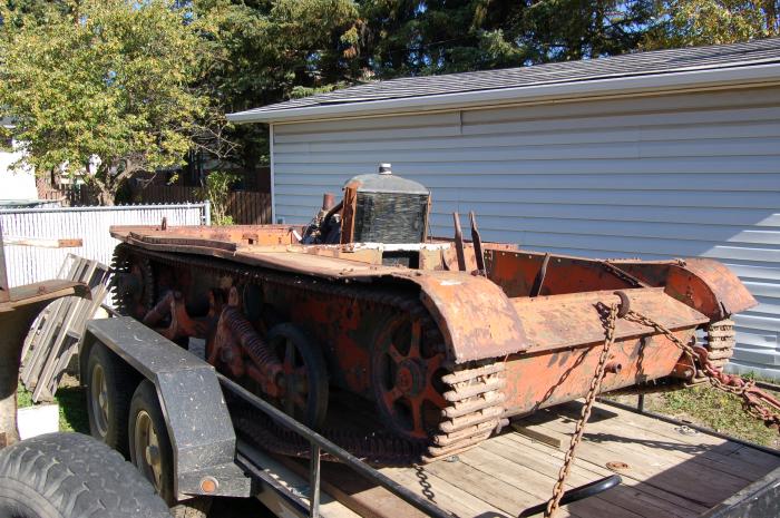

Talking Carrier Pics
Here are some pics of one of my carriers, I know I have a LOT of work ahead of me, Richard T, I will post some of the other carrier in a bit, I do not have it in my yard yet.

A few more shots.

Hi Gary, You have a start there. I just thought I'd let you know that your carrier was also once a WASP. You can tell by the roughly cut hole in the bulkhead down below the navigators seat. That was for the piping for the wasp flame thrower. Do you have any idea of the CT or the serial number? It might be very close to mine. You also have the original engine. It looks like you may only have the engine no. It is on the flat spot on the top left rear of the engine block.. Just above those oil pipes at the back of the engine. Between the cyl. head and the intake manifold.

Welcome to the forum, you are in the right place for any help that you may require, You choice of a carrier restoration is still the best way that I can think of to get rid of any surplus money that you may have,just kidding you will have a ball and the friends trhat you make here are forever,
congatulations it will be interesting to watch your progress,

Welcome Gary, and thanks for posting them up looks like you got yourself something that wee bit more special (mind all carriers are special...but you know what i mean)
what is it with teh rear bogey road wheels the rubber on them always seems to be gash. mine are exactly the same, yet the front idlers and main bogey's are all perfect, as is the little top idler

The rear bogey is the one that takes the most sideways pressure when turning sharply. It is fine when things are set rite but when the tracks are loose they want to climb on the track guids. Mine are like that too because when I was young and stupider than now I didn't adjust my tracks.( too much work, I thought) Now I couldn't believe how easy it is to adjust them. With the rite tools that is.

Thanks for the encouragement, I am excited about getting these things up and running and going for a ride...Ledsel, I found the serial number in the spot you said, (Thnx) and it is TL24877F, hope that is right.
I will be getting a second carrier on the 23rd of this month and will get pics and serial number for that one, is that the only place to get the serial?
Jeff, I live in Northern BC along the famous Alaska Highway, I was in contact with some members of the MVPA while at the abbotsford airshow about doing a trip along the highway.
Thank you all for any information, I have a friend a few hours away that has 5 carriers and figures that he can build 3 complete ones from the stock, unfortunatly he did not get any salvagable engines so he is on the hunt, he is a member of this forum but is not able to log in very ofton, I will try to get lots of picture of his projects as well as progress of my vehicles. I have 2 CMP's that I am working on as well and will be fixing the C-15 before I work on my carrier so it will be a bit before I have anything to show.

Hello Gary, looks like a good project. Don't be put off by the missing bits as over time you will find, acquire or remanufacture a lot as you go.

But from the engine number you could be fairly certain that it was a 1944 model MK.2 probably built early in March.
Definitely a mk2....the area over the rear diff does not have the two large square openings.
Following on from comments regarding carrier mark can I throw a spanner or two in the works and say, many MkI carriers were upgraded to MkII spec. which including the engines being supplied for the MkII production. Also the holes over the rear diff are also missing on some later bren carriers. Identifying the mark of carriers can only be done for sure by the edge armour information (provided it hasn't come from another carrier, which also happened during the war!). It is easier to identify earlier marks as there are tell tale fixing holes for equipment only fitted to them. Armour thickness in certain areas of the vehicle was altered so this can also assist. Could the two holes on the left mudguard be the fixings for the can holder on the MkII? It would be a great find if someone could locate a document which tied the Lower Hull Number with the Upper Hull Number with the WD Number and Serial Number. Then we would be able to run the hull numbers to find out year and marks. Start looking everyone!!!
Gary, great you have saved another two and good luck with them, it is worth it.

Thanks for the very helpful info, unfortunatly this carrier has been attacked very viciously with a cutting torch and any number other than the serial on the engine has long been cut away by a farmer trying to keep dry, (fenders were cut off and steel added to make them higher), I am getting my second carrier in a week and a day, it has a lot more to it, ie: the tracks are on it, I believe the steering wheel is attached and several other items are there, I was told that the armour seems to be the only thing missing, will post pics as soon as I can

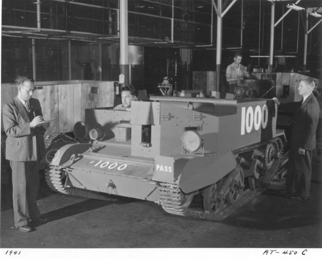

Old 20-09-09, 04:29
Originally Posted by Nigel Watson View Post
....... just trying to share my knowledge that's all.
If I can give you one example of a similar sort of thing. When I entered the world of carriers people were identifying Canadian made carriers by their distinctively shaped headlamps. Subsequently the British made Carriers were therefore identified by the conventional cone shaped lamps. Seemed a reasonable method. However I discovered documentation that showed Canada ordered the cone shaped lamps to put onto carriers they were building! So that particular method of identification was no longer accurate.
Nigel
Nigel, there is also photographic eveidence of Canadian Ford Carriers being manufactured with the UK-pattern cone headlights. How many? Certainly at least, up to the first 1000 (Probably! Possibly Maybe? ).
I agree that sharing information from a variety of sources without flaming people has seen the amount of collective information rapidly multiply in the last few years. It is always hard to provide a definitaive, concrete finding on some subject as someone will likely find proof of the exception to any rule at some later date. So the knowledge base keeps evolving and being refined.

I'm straying a bit off topic, but the hole I referred to is on Mk1 carriers, and yes, just below the gunner. As I don't see this rectangular hole (I think it's about 4" X 4"). I would use that to support the likelihood that this is a mk2 hull.
Re the cutoff for the early Lucas headlamps, the parts manual gives a cut off of approx serial 2083 and 2084 for the changeover to the Cdn lamps.

If I recall correctly, from Nigels book, a number of carriers were built by Ford of Canada,for the U.K., using components, made in the U.K. My guess though, is that your pics are of Canadian carriers for Canada, because of the horn (and the pic of no.1000)
You are right of course about the info flow, as the net gains momentum. Great! ..aint it!!!.

here you go, canadian carriers rolling out of the ford plant 1941 fitted with british style lamps no less one near the end has an extra perspex type screen fitted...possibly trialing it for use maybe ? either way all the carriers appear to be Mk1
http://www.britishpathe.com/record.php?id=12585

I did reply to richard in a private post, however on to god news for me, I got my carrier last night, (what a major pain in the buttox, I would have taken photo's but it was too dark), here are the pics I took today

You've got yourself another MKII no.2 . Also a former Wasp. You should still have the lower hull no. it's on that angle iron across the rear of the tub part of the hull on the left side right over the track when your facing the rear of the carrier. That will be the only no. that you will have. Good finds. Does the engine in this one run?
Model U.C. NO-2 MK II.*
SERIAL 25680
HULL 24699. LOWER HULL 24742. ENGINE TL-26707-F.
C.D. 2609.
BUILT MAR. 25, 1944.
CT 266677
Former WASP
