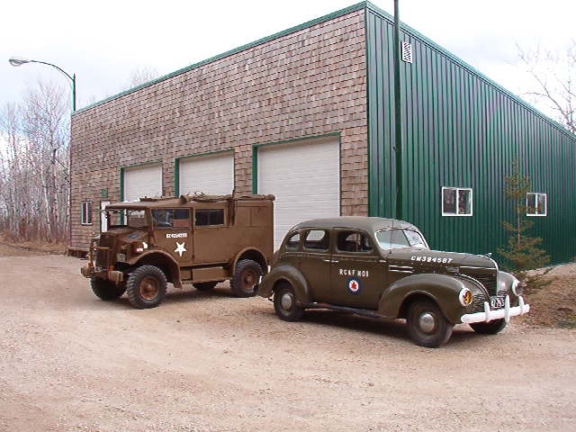

Default C8 Fast Brothers Prairie Command restoration update...
The truck has been blasted ,primed ,and painted. All the brake work is done and it is coming back together. Looking for a running 235 to drop into her. All the glass is ready for install. I have found 2 - 13inch rims and 1 original tire in nice shape. Still looking for more rims and adapters. I was fortunate to find NOS e brake cables and inside roof hatch rubber ends. See pics and keep your eyes open for those tough to find rims and adapters. Cheers Rob
