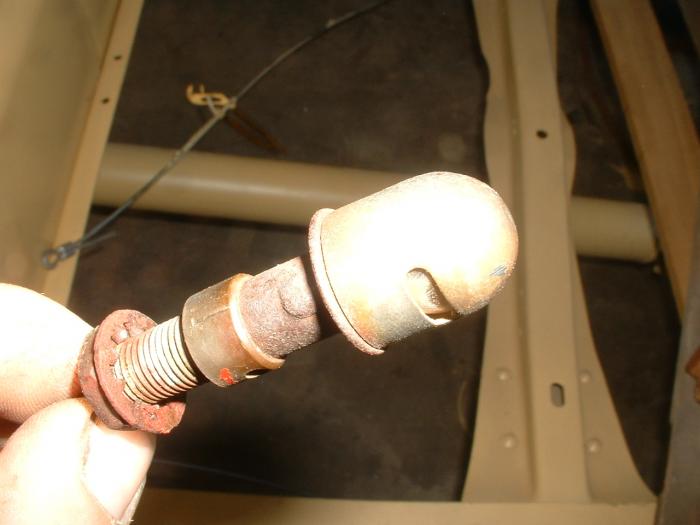

Here are a few photos of the tank cast piece after I cleaned it up a bit.
Noticed that it appears to be made of copper? Was tarnished to a deep blue-green on the inside before clean-up and the brass pieces,(arrow), are much yellower than the reddish tinted casting.
There is an "R" stamped into this casting also. Does this mean it's for a right side tank?
There is a notch cut in the front fuel tank support rail even with the fuel outlet in the tank. Is this where the fuel line should be routed?
If this is a left-side tank my brass tank outlet is facing the rear of the truck, and the casting can't be rotated 180 degrees due to the "reserve" feature made into the tank.
Thanks, David

The first picture up showed is defenitely a right hand side tank.....driver's side..... with the oval plate... but now I see how they have reversed the tanks from left to right to insure the filler cap is closer to the truck cab and near the outside for access...... at the same time it allowed to centralized the two oval plate for fuel line hook up....... wonder if they did that on purpose to screw up guys like us trying to restored them 65 years later.
Thanks for the oval brass plate close up...... my best two tanks are steel adn there are some marking differences in the letterring and reserve lever shape....... again I have two different type of levers for the reserve... one of which is identical to the 3 way valve.
Have you tried to remove one of the oval plate...? we have been soaking a lesser example with GBS to loosen up rust and will try our hands with a hand held impact screwdriver......

I did have to use a mist of glass cleaner on the gauge faces to slide the decals under the needles. Would have been almost impossible without it.
Got the dash panel repaired and painted today, and instrument cluster installed for good.
Had a question whether the little light fixture I have is original or not. Fits above the ignition switch in an existing hole, but every cab 11/12 interior photo I have doesn't show this light. It also isn't noted in the cab 11 wiring diagram either,(courtesy of Collin Stevens website).
Thanks, David

Looks like a dash light from a late cab 13 dash
Top half without the base ring

Hi David
From all the cab 11/12 and C8 I have seen I have never seen that little dash light. That being said it is old and looks right in that spot. Your light has a very diffirent configuration that those seen on cab 13 or even jeeps......
If it works and serves a purpose keep it in place..... makes your truck unique.
Nice to catch up on your site on Monday morning and see the progress you are making..... keep it up.

Thanks Andrew and Bob,
Was browsing around looking at cab 11/12 dash photos, and noticed this one has a hole in the same spot, but no light...
Also noticed that the wiring diagram shows three instrument lights. The cluster only has two, so where is the third one supposed to be? I had been looking at the headlight high beam indicator light on the back of the cluster and thinking it was the third light...
Oh well, I'll just paint it and keep it in. It looks good, serves a purpose and I don't want to weld the hole up and re-finish the dash again.

David, that's the hole that the vacuum line for the wipers goes through then it runs up the inside of the windshield centre post to a tee above the windshield.

Thanks, David!
Haven't even thought about the vaccuum windshield wiper installation yet! Just learning this stuff as I go along, and I'm sure many mistakes and wrong assumptions are to follow.....
Your imput is always greatly appreciated as your C8 is very close to mine in production.
Not trying to keep beating a dead horse here, but there is also another hole of the same size in the crest of the angle iron just above the hole the light was in...
Any thoughts?
Thanks, David

Hi David
See the two pictures.... the first one is my own dash set up for my C15a cab 11....the other from a cab 11 in a junk yard
It is the hole for the vacuum line.....
Boob

Ok! That laid that to rest......
Little light goes in the extra parts bin, and onto other things!
Thanks all for the great information. Couldn't get this far without you guys!
Thanks again, David

On my C15 the windshield is pushed back in the centre and I couldn't see that other hole. I looked under the hood and sure enough that's where the wiper vacuum hose goes up through the dash. I'll check my C8 tomorrow to see what I've missed.
