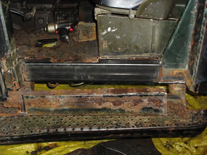

allrigth , today i have had the cab off and started cleaning and removing stuff from the frame , i also started to cut off the wood carrying gizmo that where welded to the frame with the plasma cutter, did i tell everyone how much that tool is fun to use , ge i like my plasma cutter...lol
any how here are the pics, enjoy!!
cab less frame started to be cleaned
wood shit started to plasma off
the cab is in very nice shape found just a few hole to fix

Hello i did my m37 last year, i think the 2 main beam on the cab were a little bit more damaged. But now thay are replaced by two 2x4-1/8 thick. Just need to make a little angle becaus the beam is not straight at the end.
I think your plasma cutter will be yousfull.
