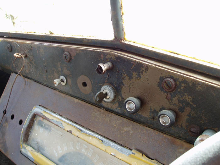

David, Excellent work on the dash! I can certainly use this as a guide when I get to refurbish my gauge cluster....although my speedo gauge was lying rusted on the cabin floor with the needle missing in action.
I have attached a few pics of my C8 dash to add to the discussion.

Default The value of a picture
Well there it is. The light belongs there. You'd better retrieve your light from the bin David.

Thanks a million, Alex!
A picture is truly worth a thousand words! Thanks everyone for all your help.
The little light goes back on....
Thanks, David

No Problem David. I checked some pictures this morning and Nick Bullock's C8 also has the light So, I recon it is a real wartime configuration.

I checked and my C8 had the light there too. They say the memory is the first thing to go, don't they?

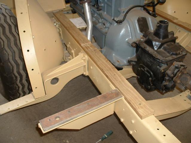

Hotter than Hell here in Texas, but in spite of it actually made good visual progress on the truck this weekend. Only advantage to the heat is my paint dries very fast!
Pulled the truck out of it's corner of the shop for the first time in months. It's actually starting to look like a vehicle again instead of just a very interesting pile of parts.
Cut and prepared new wood strips for the floor plates and primed, painted and installed the floor plates for good. Had to trim the large floor plate to accomodate the new SM420 transmission, but removed much less material than I had expected.
One thing I am noticing is as I install more cab components, the room for the driver is going away fast! Also installed glass in the windshield frame, but can't install the frame for good as roof components have to be put on the outer windshield frame first. Next weekend for that...
Thanks, David
