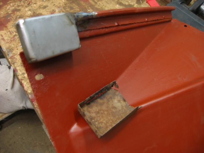

Default more parts done...
thanks guy's for the thumps up.
he tony come on you can do it, you can do those doors
for me I can't stop so here are some more parts I have done. some neaded some welding like a new rain gutter cup ? or something.
I did the front two noseparts they neaded some hammering to get them into shape. the nose pice was easy it was like new and I putt the chevy embleme on it, looks nice now. I did the inside driverside pannel to and the bonnet pannel.
chees jaap

so when I have to change the filter I take the back cover away and I can change the filter.
I can take some more pictures if that neaded just let me know.
hope this helped bob.
cheers jaap
