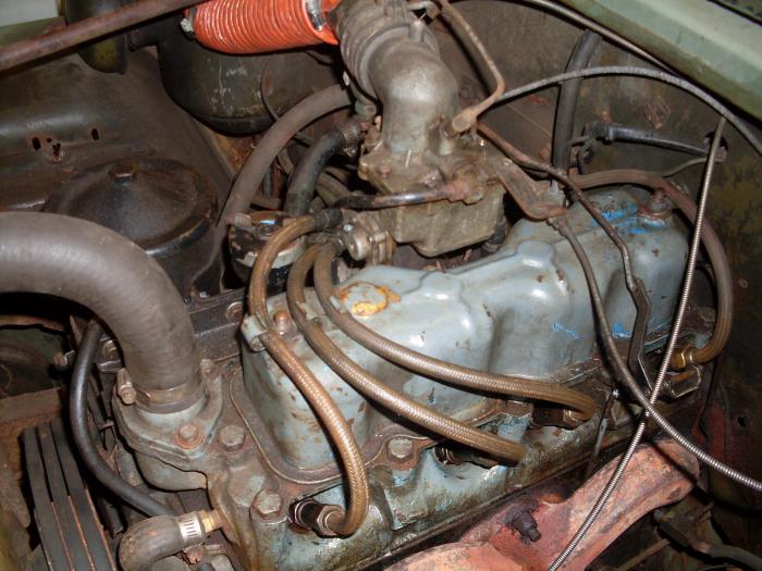

Hello, Picked this up with an extra engine. Can anyone help me with the BM on the windshield frame? Also there is a guy selling a Cj2a. Its a 1946 civl. I drove it today.No Brakes haha.

BM most probably indicates "Brigade Major".
Looks like a CDN2...no heater.

Can't say as I have heard that term. More likely it is one of the codes that the vehicle may have been held under. Often, if a vehicle was being held as national stock, or as controlled cannibalization, the two letter code could be stencilled onto the vehicle. I am not familiar with the letters BM, mind you, but then again I have been out of the EME system for a number of years now.
I can see the heater deflector box in the photo, so the heater would have been installed at one time or another. How can you tell it's missing Jon?
There are a couple easy ways to tell Cdn two from Cdn 3. Are the hood hinges slotted to allow removal of the hood (Cdn2) or solid (Cdn3)? Does the rear axle have the little hub caps in the center (Cdn2) or is it a flatish one piece axle (Cdn3). Lastly, if you look at the frame just over the front mounting points of the rear springs, is the frame an open C channel (Cdn2) or are there a couple 6" plates boxing the frame in this area on both sides? (Cdn3). The earlier Cdn2 were prone to cracking in this area, so this was an improvement when the Cdn3s were being assembled.

hello, yah i can get some better pics tomorrow!!! Kind of funny you mention brigade major... the guy I bought it off of said he bought it from a Vet that was high ranking!!!?.(retired working at the same airport) Use to take it into parades. I will ask him when I go to pick up the second spare engine. I will also check out the hood and axle. When i bought it I think the guy might have taken the heater out of it.( laying beside the spare engine with his doors for other m38a1) Maybe I should try and buy it?(how much they worth?)Anyways Iam really pumped to get this thing back in good condition Thanks for any help or comments you guys/girls can give me. Brad

Looks like a Cdn3. The rear axle is the latest type. The rest of the photos don't show the details needed to determine. Take a shot of the insides of the frame just over the rear springs at the front hangers. You can also take a shot of the front brake backing plates.
Axles could be swapped between the years, but it wasn't quite that easy. The rear axle of a Cdn3 was a larger diameter, so you also had to replace the U bolts and the plates, so with that in mind, your is likely a Cdn3. The frame photo will tell for sure.
