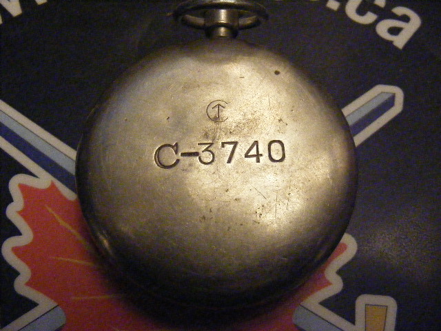

Yes, there is a proper pocket watch for the 19 set. The Canadian examples I have seen had the C/i\ on the back along with a serial number. The only marking on the face, other than the numbers etc, is "swiss" on the very bottom.
The TPGP (time piece general purpose) is very similar but has a black face. The 19 set watch has white.

With regards to the pocket watch used in the WS No. 19 watch holder (and other sets similarly equipped), to confirm Rob's information, you do need to find a watch with the three key lines of information on the back cover showing it was military issue: the British or Canadian Acceptance Mark, the letters G.S.T.P. and the serial number. The serial number should have a single letter prefix, which in the case of Canadian watches will be a 'C'.

Lastly, be wary of fakes on eBay. Always take a close look at the markings on the back cover. At first glance they appear to have been stamped into the metal, but if you look closely, you will notice there is never any depressed metal around the edges of the letters etc. which a stamping machine typically creates. If you see signs of stamping - walk away from the watch. The markings were actually produced by an engraving tool. If you look closely you can see the traces of where the engraving head was spinning as it forms each letter and number. You can also spot the start and stop points at each end of the letters and numbers where the engraving head has moved into and out of the metal. I have seen some watches on eBay that have clearly been marked with a modern vibrating engraving tool - if you see it - walk away.
