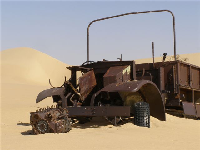

After a fairly long absence, again something historical from my side if you like:
The only known LRDG patrol truck in Egypt sitting on the old route from Ain Dalla to Big Cairn. I had the chance to write a small article in a UK magazine's February '11 issue. Nice truck:
Size:  36.1 KB Click image for larger version
ID:	121360 Click image for larger version
http://wuestenschiff.de/phpbb/userpi...010_3409_1.jpg http://wuestenschiff.de/phpbb/userpi...010_3418_1.jpg http://wuestenschiff.de/phpbb/userpi..._Veteran_1.jpg

Wow, its amazing how well things stay so preserved in the desert. Other pics I have seen looks like constant sand blasting so rust can't get a chance to start.
Colin.

Kuno,
Is that an F30S or an F60L? The tyre looks like a 10.50x16 sand tyre.
It is certainly an early Cab 11, with the lifting rings behind the bumper bar.
I have an early F30S Cab 11 with Chevrolet diffs here.
You have shown this one before, but it is a great artifact of WW11.
Regards Rick.

It's an F30. And I have not shown it before as far as I know...

That's a Mid-East theatre number I think. I am guessing, after a bit of detective work, that it's a # 12 cab model EC01QF F60L deilvered to Alexandria under Demand S/M 2019. E.g. L 4713093, as per IWM PHOTO KID 2453 which had sand tyres.

A F30 is a F30. It's the F60 that is a L or S. Long has 12' body and short is a F30 with higher spring rating. The 11 Cab F30, as found by Kuno, had Marmon Harrington axles (i.e. Banjo)

The serial number on the tail board was 4406114 which puts it among the LRDG trucks delivered to them in 1941.
Probably in the batch delivered under S/M 2003 direct to Alexandria.
The F30S and C30S designations were used it seems for the 1940 Models...it appears that after it became clear that no lwb versions would be ordered, they dropped the S suffix. I have yet to see any official paperwork on that though.
Yes, and the absence of the cab vent holes on the inner cowl.
it was abandoned with steering problems
Could well the the same one than! I would love to see the "old" pics.

Been speaking to the son of Y patrol veteran and he is certain that Kuno's Ford is the same one that the oil workers pulled out. He says that there were nearly 200 Army Forms on board and he has now identified about 150 as LRDG men. Hope to get a couple of photos posted.

Dear Colleagues; I am not very familiar with the serial numbers painted on the CMP trucks and don't know what they tell about manufacturing year and so on - may one of you explain me what he can read from this photo?
BTW - the number is painted on the LRDG patrol truck resting in the Sand Sea in Egypt. I forgot to look for it when I was there in 2010 ... luckily, others think further
Old 15-07-14, 08:46
Kuno,
What you show is L4406114, the War Department census number, the formal registration number assigned to this truck. L stands for the lorry class of vehicles.
Do you have a picture of the complete truck? That would help in identifying it further.
Old 15-07-14, 20:55
Kuno Kuno is offline
Join Date: Feb 2004
Posts: 536
Hi Hanno - it is the famous LRDG Ford in the Sand Sea near Ain Dalla:
