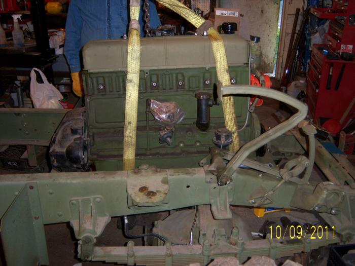

I need the inout of Phil W. ( if he has not floated away wtih Irene) and any one else who has tackled re-assembly of a cab 11 or 12..... so wake up dwon under.
I have attached the proverbial photo worth a thousand words.
Looking at the front of my truck the pass. side of the frame is twisted upwards. Did not think it was serious until I started installing the fender / nose brackets to the arches......
AT first I believed the "horse collar" that holds radiator was installed wrong...wrong spacers or something. So I drained the rad, pulled it off
( repainted it while at it) and found out I was wrong or that the installation had the right spacers, etc.
What I was noticing was the horse collar was not centered...driver's side had a gap over one inch while the pass. ride was tight fitting. Well the rad and horse collar ARE centered its the darn twisting.
Look at the picture with the steel rod inserted in holes in the horse collar... the pass. side is protruding forward about 1.5 inches and about 2 inches higher. I applied square dots of white paper for reference.
In all the pictures the camera was on a tripod so the sa,e point of references can be observed.
So back to the drawing board....visit to the 4 parts cab 12 that I have in the back field. Well the cab 12 has a interesting modification that must have dealt with some problems with the cab 11. They installed a fairly rigid 5/8 steel bar tying together each fender/nose bracket. The steel rod has to travel behind the rad and avoid the fan. Well of the 4 trucks only one still had an original rod in place. so we removed it carefully and set about making a duplicate for my cab 11.... the original will go back for future references.
So with Master Grant as my coach we designed a jig that woudl allow to heat and bend a duplicate of the origianl bar. I made the two flat ends from flat bar stock and as the rain was starting to fall ( beginning of Irene) we hurriedly positioned the bar on the welding table under a light drizzel. somewhere along the process I nudged one fo the end plates... it fell and I repositioned it upside down. There is a clearance cirtical dimension issue with the flat end plate.... so it got welded 180 degree the wrong way.
Solution.... cut off the plate... make a new one and re weld...Voila.
BUT ..... my bigger twisting problem has not been eliminated.
I am hoping that this stiff rigid brace will pull the brackets and arches in line when fully tighned in place. Timew will tell
I remember Phil assembling his cab 12 with a whole bunch of 1 1/2 loose fitting 1/4 bolts until he could literally shake the loosely assembled cab in place then replacing with proper bolts and tightening each one properly.
It almost seems that one dis-assembled the cab11/12 have a tendency to relax and partly regain it former shape....almost like some pastic have a memory and once heated will partly return to there original shape.
I am even considering taking the rolling chassis toa frame staithening shop if necessary.
Comments... suggestions... incantations and new swear words welcomed.....

did such a good job at inserting the 5/8 rod partly in the 3/8 plate and plug welded the end..... that I will now have to carve out the plate around the rod.....can't cut the rod as it would now be tooooo short.
Will redo it this weekend. It all good welding/fabricating experience.

What CMP does not have a slight tilt? As we have seen, all of our restoration project trucks at the barn have that characteristic. The "tilt" on my HUP was quite noticeable until the body was re-installed. I suspect the same will be true with Grant's rad van.
Once your sheet metal is back on I suspect that things will fall into place, and as you mentioned, the "loose assembly method" may be necessary prior to tightening things up.
How much play do you have in your sheet metal (i.e. bolt holes)?
In any case, getting up close and personal with a CMP shows that these beasts have their quirks. I am sure that you will as always, find a way to make things work.
Bob,
Sorry to hear you run into this problem. I would rectify what seems to be the cause of your problem: the twisted frame. It looks to me that if you remove the twist from your truck's frame, the tilt in the cab will be practically gone and can be adjusted by using Phil's method - proof of these early CMPs being "thrown together?
Good luck,

Point raised by Rob C. .... most of the cab bolts are 1/4 stove bolts..... holes were at least 3/8 and some were cut oblong almost 1/2 inch long.
Bigger 5/16 and 3/8 bolts for fenders and such have corresponding larger hole to allow for alignment.........
Hanno's point is correct... if the base is crooked so will the rest.
I will need to investigate what frame straightening facilities exists in Ottawa and costs.......
For the record all 4 spring packs were disassembled, cleaned. leaves fabricated and replaced as necessary and the total spring pack re-arched..... so the two front ones were very similar in dimensions when installed.
Maybe the ground is crooked......!!!!

Visited a frame straighteneing shop this morning.....small shop...owner on site with time to talk.
I had brought some pictures which I will share with you tonite.
Steps to be considered....
Build a level platform for the front axle
Select two tires that are within 1/4 inch in height from one another.
..... adjust air pressure to bring to perfect level.
Measure and measure and remeasure and write it down on a picture.
measure space between frame and each spring....frame to level plate, etc.
Consider removing spring packs and switching sides...
measure and remeasure each time.
Having explained that the front cross member and engine support cross member had been removed and replaced....
Loosen all bolts..... including the arches attached to the frame and loosen bolts of bumper....
measure and remeasure......
build jig that can hydraulically twist the frame in the proper direction while the bolts are all loose.......
Measure when all is straight....
Over twist frame by known amount
measure over twist.
relax hydraulic set up
measure to see how much has been gained and how much has sprung back.
repeat process
This sounds like a multi weekend process.
Promise to document/photo my progress or lack thereof.
Cost estimate......$300 to measure and assess what needs to be done....
......$1000 minimum to actually do all of the above......
Or do it all yourself.... free and the experieince is priceless..

It should be fairly quick and not too dirty to swap the springs side to side to see if the problem reverses itself or (better) goes away. Is there a spare front spring we can use in the process? 1 spring out, the temp in, the other spring out, the first one into where the second came from then the second to replace the temp where the first started out. This would mean the axle and frame are always connected, no need to remove the brake lines, steering etc or support and restrain the axle and frame as much as if you removed both springs at the same time. Even quicker if the bushing in the temp spring is a bit sloppy.
Any frame built to be able to jack the frame back into shape will need to be quite a bit stonger than the truck frame. Big and heavy. Is there a good source of recycled (cheaper) steel beams close to the barn?
I'd better hurry up and get my frame back into rolling shape so we can bring yours into the barn. To that end, I've got enough shim stock on order (supposed to arrive tomorrow) to do the pivots on a dozen front axles. Standard sizes.... If it arrives as promised, the frame should be rolling with brakes by the end of the weekend, not sure about whether the engine will be in the frame.

a few wedge type anchors into your shop floor and some basic hydraulics should give you with the aid of some steel struts the ability to gently force things nicely and safely.

Will get yours finished first with engine tranny etc.....
I will have to focus some time on fire wood over September anyways.
Need to plan and maybe make a list of steps....take more photos to be enlarged to write down dimensions, etc....
The welded frame would be large square tubing....free standing that would sit astride the front of the frame..... such as a large door frame.... with provision for using our body jack......
I like Robin's idea of a ground anchor as used in larger frame shops...... would require drilling the floor..... or breaking a hole where it is cracked and cementing a large anchoring device.
I ain't gonna quit yet......
I was cautioned this mroning to proceed one step at a time with careful measurments..... we may not need the big guns once we have tried the spring swap and/or the loose bolt approach....... and yes we must have a spare spring pack somewhere..... also have a lot of jack stands....and can hang from overhead crane......
... and we have a large supply of oil for Lucifer....
Remember we removed and replaced your front cross member as well so we may have another one to do...hihihi

The saving grace for mine may be that only 1 member was removed, The bumper, hat section behind, rear of engine crossmember, springs and axles were all left in place with weight on wheels while I removed the front of engine member. I also don't recall seing any misalignment of the holes developing as the crossmember was freed (but I wasn't watching for it either). If you are planning your frame inside at the back by Lucifer for the winter we have more cleanup to do back there (need to make the smaller wood crib anyway). I should try winder sticks before putting installing the engine and cab frame to avoid having to undo too much stuff iff there's a problem.

I agree with Mr Clarke lads...I suspect they all have a bend in 'em. One side or the other.
Grants idea of swapping springs is a good one.
When I reassembled mine I must confess it was pretty straight compared to your's in that earlier picture Bob.
Having said that, when you go to bolt it back together. Even if the chassis bend is corrected. Things still arent going to go back together like lego.
Guards and panels will be done up and undone. My biggest ally was two or three good screw drivers to jam through holes to get panels to line up with their holes. Just enough to tap a few bolts through the adjacent holes and then slowly do up to gently pull the panel or guard into place.
You will have to do this - there will be no way around it.

Well If I can get it within 1/2 inch instead of 1 to 2 inches I will be happy.
Been doing research on the frame thing on various web site including U tube.
Most are oriented to unitized construction where they just pull and stretch until things look like a car again. But then there is one site that deals wtih antiques...... thye are concerned with a 1/4 or 1/2 inch difference. Still some good ideas/pointers. Like the guy in Ottawa told me you need to take a lot of measurements...then some more..... otherwise with out a baseline you do not know where you are going.
The springs a definitely high on the to do list..... but unless I measure first I will not know how much of an improvement I may have. Matching tires is easy to do as I will install two of the new 10:50 tires that are matched then adjust air pressure to get even closer.
Loosening up all the bolts on the two front most frame cross member may make a difference..... I will also loosened the front bumper and the arches.
Removing that rigid 14 inch floor plate bolted tightly to the frame may also have an impact.
I would like to get closer to a better level stance before applying any hydraulic pressure to the frame.
I visited a few bodyshop suppliers today to see if they knew of any (reputabel ?) body shop that woudl have a frame straigthening set up.
I drew a blank most commented on the lack of need as a modern unitized constrcution vehicle/car that needs that much work the insurance company will just scrap it. A rebuilt "branded" vehicle has to be inspected, at the new buyers cost and time before plates are issued.
Comments about the huge floor space ti takes up with diminishing demand has basically killed it except for very expensive cars/antiques. One guy commmented that if I found one in use the operator would be an ol .... he looked at me and corrected himself..... well not a young man.
Yes I expect to have to use drift/alignment pins when working on the assembly.
Will keep you posted of our progress....meanwhile I am keeping my truck parked on a hill so it won't look so bad.

Now to your questions about trying to get vehicles to sit straight and level. My Pattern 12 had been rolled which bent the front cab frame, Bob found me a replacement cab frame and front fender which is all painted and ready to install as soon as BEAST is back together. Also have a 235 engine to put into the Pattern 12 at the same time.
The bent cab frame made it impossible to all the body panels on the cab to line back up on reassembly. The holes all of which had bolts when it came apart but was sprung bad enough that when trying to reassemble even with a 10 frame jack I could not get some of the bolt holes to line up some of them 2 inches off.
Trying to find where the out of level comes in the combination of springs, frame, and tires is a real puzzle. BEAST my HUP has always sat with a slight list to the drivers side. Even with all new tires it had a tilt. When I had it apart I tried to find the difference in the leaf springs. Unloaded the spring sets right to left measured the same. Bare frame measured on a nearly perfectly flat floor in the shop was within 1/8th inch of being flat and was square when measured across the diagonal. With all this done you would think that the HUP would sit flat when reassembled.
Well I've just put the body back on the frame, not level. So my only answer is that the body just plain is heavy on one side.

I will not try to make the frame perfect.... that would not be CMP original but at least less of a tilt.

Another milestone was reached at the barn on Saturday. Grant mounted his engine into the frame of his truck. The hold up was a broken off bolt in the block of his engine. After five attempts Bob managed to weld a nut onto the broken bolt and out it came.
Grant then used the overhead gantry to coax the engine into place. Grant was then heard to say "Now, it looks like a truck."

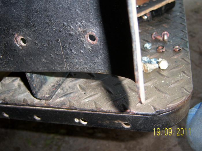

The weather this morning was more seasonal than the last few mornings, so with nothing better to do, I spent the morning at the Hammond Barn. The tasks this morning included finish cleaning up my rusty tools, and to install the rear fender to running board connector plates (that's what I call them anyway). The plates attach to the end rail of the running board and to the fender itself. A quick check of the Prototype HUP surprised me - both the front and rear fenders attach directly to the running boards. The 45 HUP only has the rear fenders attached to the running boards. I guess this gives the 45 a little more flexibility going cross country.
Back to the job - the fenders were not too cooperative. Not surprising as they were bent, twisted and torn up when I got the HUP. They now look good, but there was some twisting when they got repaired that made the installation of the plates more of a challenge.
The trick to installing the plates was to use force. The fenders were unbolted from the frame to allow for some movement. The plates were attached to the running board by four bolts and nuts. The running board was raised by using a jack and this generally lined up the screw holes in the top of the plate and on the fender. Four large slotted round headed machine screws were attached through the fender and then through the plate by four nuts. This made the plate draw the fender to it and the fender actually looks properly lined up.
Once the jack was removed, the fender bolts were retightened, and the job was complete.
