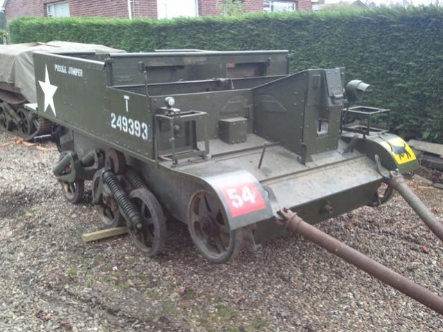

After 11 years on the road and covering a minimum of 300 miles a year i thought it was time for a major strip and inspection of my No2 Mk2* Novembe 1944 universal carrier (Puddle Jumper as its know to many). It has had the standard pre season service each year and a few major services but now is the time for a really good go through. I have already taken off most of the access covers and pannels etc to copy for my MK1 project so it half way there already.
The many years of going to the War and Peace show has ment there is dust in every where, as well as a build up of dirt and some rust under fuel tanks etc.
The engine and transmission are still in good order but now has a few leaks etc which will now be fixed. the sprockets are just showing the signs of ware but nothing major yet. i have a really good set of track to fit once all is done.
The only damaged part so far is the cush drive between the fan and dynamo , which has for some reason broken up. But having made one for the MK 1 i know it is not a hard peace to reproduce.
So first things first, a good pressure wash , btu that will be next week. I am posting some photos of the strip down and areas not oftern seen as well as a bit of detail.
enjoy !

Default plugs out..holes open..
Originally Posted by shaun View Post
The "A" team turned up to help yesterday in the form of 2 mates Steve and Josh Garrett, Steves a serving REME WO1 and Josh joined the Army 2 months ago . so between the 3 of us we had REME servicemen of bottm of the tree - top of the tree - past the tree ! But this did all help in getting the engine and transmission back in the hull after a freshen up with some fresh paint between the engine rails.
This is all a bit familier from a few months back with the MK1 ! and i think i will be doing this all again on another carrier in a month or so !! But thats another story !
It looks to me that who ever sprayed that engine didn't plug the plug holes and sprayed paint right into the engine..
I'm sure that the plugs went in after the spray job and the engine..has now hardened spray paint in on top of the pistons..
I'm sure that that will break down and be exhausted but would bet $$$$$$$$ that the oil would be effected by the burnt and lingering paint residue and will happen as soon as the gas mixture hits the paint..
Lot easier to do it right the first time that do it over..
Just my observations but I may be wrong..

Old 31-12-11, 15:23
shaun shaun is offline
Join Date: Feb 2009
Location: uk

Old 31-12-11, 15:26
Join Date: Feb 2009
Location: uk
Posts: 528
Alex - i will let you know the out come !

I might well have plugged the plug holes to save paint getting in the threads. But I would think that the tiny amount of paint that would end up on the valve heads would be blown out the exhaust in a very few revolutions. Ron

Old 31-12-11, 22:09
Location: Ottawa ,Canada
Posts: 2,916
Default Great work..
Shaun..
I have been following your rebuild and admire your work..
I have rebuilt and painted many an old flat head and found that a ball of old masking tape made an ideal plug for the plug holes..'
I just thought that ,being so fussy with he rest of your work you would have plugged the holes before painting..
Probably will get away with it..They are pretty forgiving..but I did loose one with old oil,contaminated with condensation..so it doesn't take much.
Happy new Year and keep up the great pictures..
