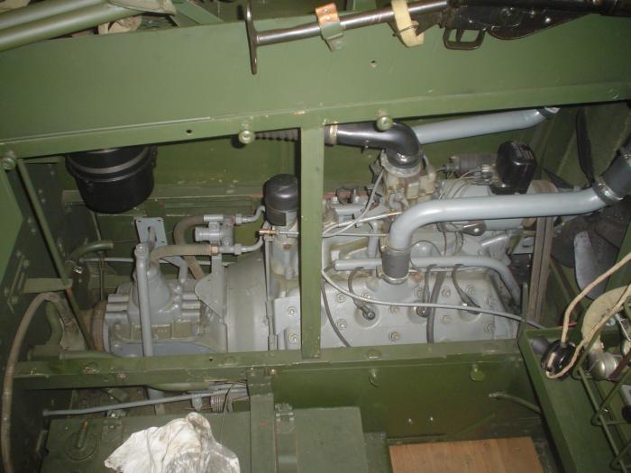

Can any one comment please on how easy I am going to find taking the starter motor off my Canadian Mk11* Carrier.
I have removed the Tool Box, hopefully the Fuel Tank does not also need to be removed.

Neil, I think you will have to remove the tank, the starter is held on by two studs which pass the complete length of the starter and hold it all together so be careful not to let it all fall to bits on removal, I regret the day when I first removed one of these and received a blunt trauma to my left eye.

Neil, you should be able to get it off leaving all that in place and just removing the lower engine pannel by the statrer, remember the starter is forward of the fuel tank etc. its not to bad a job, i have done it on the side of the road before now.

I was getting ready to remove the starter on mine a few months back. I was also hoping to get away without taking the tank out. It looked possible! Which Shaun has confirmed. As you might remember. Mine is fitted with a 12V system and remote solenoid for the starter. It was in fact the solenoid that was the problem. Ron
