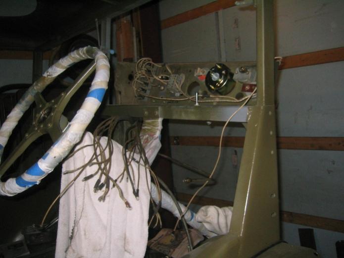

I really would like to know how they wired the dash. Just can not figure out an easy way to do it. The problem is the support for the steering wheel which blocks every thing. If you take the support out and wire everything then it is hard to get the bolts of the support in.
Name:	WEB 2012 HUP June 025.jpg
ID:	49875 Click image for larger version
Name:	WEB 2012 HUP June 026.jpg
Best way I found for doing it is with nose off, take the dash and put it up side down on the window ledge. Then wire everything up and test it then remove the lower part of the steering support and swing the dash down some of the wires have to go be hid the support as does the speedometer cable and oil line.
Name:	WEB 2012 HUP June 029.jpg
