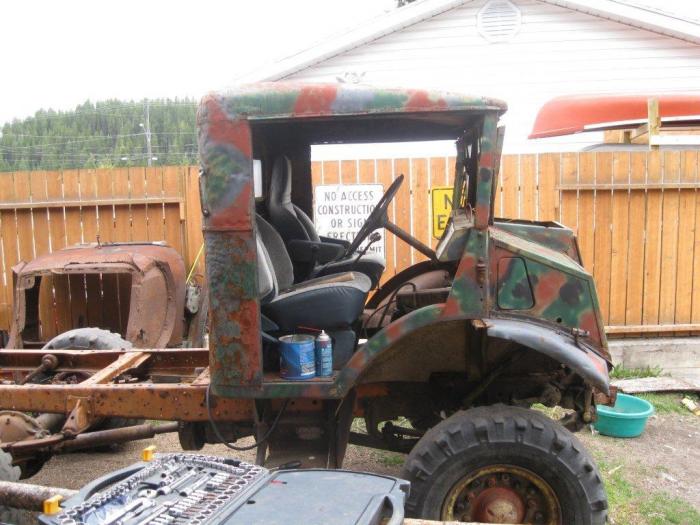

Found this truck in the back 40 of one of the local haywires. Bought it for $700, drove it home the same day with 2 flat tires and the box tied down with a rope. It took 3 hrs to go 4 kms, totally worth the drive. That was about 10 years ago, I finally brought it home, from my parents farm, in October. Now comes the fun part the re and re...

We use here our real names ;-) Just a few thoughts on your Blitz:
- A Ford-Cab (or at least a badge) and a straight 6 engine. That doesn't fit. The Ford's used V8.
- The Cab is a No 13, so most likely your Blitz isn't from 1941 or the original cab was replaced sometimes.

The rear ends are both Ford as are the shock absorbers. The motor is a 1960s Chev 230 inline six. The box has a US military look to it. The 13 cab makes it 1942 or newer.
I'd say it's a Ford with the Chev engine replacing the flattie and a US box, but it's a CMP and that's what really counts!

The truck is a Ford and the previous owner put the Chev motor in it in the early 70's and junked the flathead. He was the one that told me it was a '41. Progress is going to get real slow as I have no shop/shed to work in and it started to snow today... And it is in rough shape as the previous owner used it as a log skidder. Thanks for correcting me on the year, I'm just winging it on this truck.

I was wrong about the box. When I saw the rear pic I could tell it's a 1B1 off a 1941 Cab 12 8cwt. That will make good trading material for you.

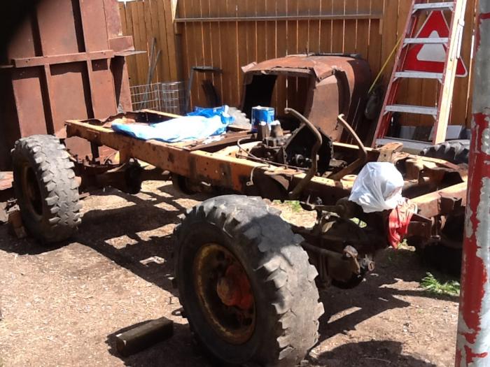

Well hows that for slow progress. Finally got my but in gear and pulled the cab off today. Might actually get the motor out next week. This truck is rough, the frame has a bunch of hole made by a cutting torch, notches cut out of 2 of the cross members, the rear cross member is almost pulled right in two and bunch of extra stuff welded onto the frame rails. So this has changed from a resto to a rebuild for offroad/mud truck. I hope I dont offend anyone by doing this but... theres not a whole lot of the original truck to work with. I'll post some pictures of the progress later this week.

Cabs off getting ready to pull the tired old I-6 Chevy

sorry had to find and resize pics
Rob T.
Old 12-06-12, 04:37
Posts: 5,268
Default Ah.... now I see....
Good job....
You might find it a little easier if you removed the nose piece first as a separate item.....
what are your next steps...?
Old 12-06-12, 07:18
Kootenay Cruiser Kootenay Cruiser is offline
Join Date: Nov 2010
Location: Elkford BC Canada
Posts: 33
Probably pull the motor tomorrow, get rid of the hokey motor mounts,get rid of anything thats not going to get used, start on re plumbing the brake lines...

engines out, tomorrow will be pressure wash day
Rob T.
Old 13-06-12, 05:05
Posts: 5,268
Default Looking good....
Frame is in good shape....... boy that Furd thing must have felt relieved to have the Chev engine removed from the V8 bay.......
