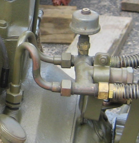

ok, so here goes, fist the photos then the explanation
in the top photo this is the set up as the vehicle came from the British Army, as far as I know. I have not altered it and the soldered seal on the pressure relief valve was stamped with an inspectors mark. It would appear to me, that the British, or a later Ford modification, has directed the oil relief flow to the point above the fuel pump as you can see in the photo. It is this oil flow, that I believe is finding its way into the fuel pump and flowing out of the petrol relief hole.
The set up as seen in the photo from the TM is quite different. It would appear that the relief valve is on the other side of the two pipes to mine. In other words either the pick up pipe has been changed on my engine, about 12 months later than the date of the TM, or it has been muddled by British Army when they made this mod.
So in the TM photo, it would appear that the pipe nearest in the photo is the return to the engine and the outlet pipe to the oil cooler has the oil pressure gauge and the relief valve attached to it. I assume if there is a restriction in this circuit it returns through the brass interconnection back to the return into the crankcase.
On my engine , you will see that my pressure gauge and relief valve are on the other pipe and the relief has been redirected to the oil filler pipe.
It may well be that I have followed the schematic in the TM ( another diagram not illustrated here) and connected the pipes on the flexible section of the oil cooler lines the wrong way around. I can check this today, but it still does not explain why these pipes are completely different from the set up in the TM. Go figure, and if you can work it out, please let me know.
Meanwhile, I plan at some stage to remove both pipes and check which way the oil flows from my engine left or right pipe then I can connect the cooler pipes the right way around for sure.

Attached a shot of my oil cooler lines even though its a different setup. Yours appears to have a second breather on the driver side of the rear engine. I've got that part connected to the top of my differential and don't have another breather on the engine other than the one where the oil enters the engine at the fuel pump where you are having the leak.
From your routing, the by-pass is open and sending the oil to the upper line. It's leaking is probably related to either the engine having too much internal pressure or air is coming in from the second breather and exiting from the higher original factory one and causing issues with the oil trying to flow inward against it.
Not real sure what the purpose of the alternate oil route would be since I've never seen that on another vehicle so far. If it was providing essential oil, they wouldn't have made it only functional when the valve was in by-pass mode.
Can you open the lines up front and confirm that oil will flow from the oil cooler lines? Or do you have the oil cooler shut off by manual lever if still installed? I don't have the levers on mine so can't turn them off if I wanted to.

To be clear I thought I would just summarise the issue
1. My set up appear to have the oil pressure and relief valve on the other elbow to the book and David Gordons. This is odd as I assume only one of these elbows flows pumped oil out, the other is a return.
2. Which elbow flow oil out?
3. Did the arrangement of these oil pick ups change for some reason?
4. If mine is taking oil from the wrong elbow it will be sending it back in against the oil trying to flow out?
5. If I have followed the schematic when I hooked up the cooler lines, I may well have got the oil flowing into the wrong union on the cooler. Could this be affecting my flow rate through the cooler, and causing the relief valve to operate and dump oil onto the fuel pump?
Hope thats all clear thanks A

Here is my take on the PRV: Originally Flathead V8s only had one PRV, that in the valley of the block. Oil passed up from the pump then turned right just under the tappings in the top of the bell housing and went into the valley on it's way to oil the bearings etc.. (not the rear main though), pressure was controlled by the PRV at the front on the valley. When you break into the oil system before the PRV, (which you do when you utilise the bell housing tappings) that oil pressure is unregulated. When they fitted the oil cooler, the additional PRV was added to protect the cooler from bursting due to over pressure in the event of a cooler / pipe blockage and possibly as a form of cooler bypass when the oil was cold and more viscous (not on Yours Andrew, that is just for safety) However on later wartime Flatheads ford came up with a proper PRV system as part of the pump, thus oil at the bell housing is regulated.
What pump did you fit Andrew? If you have the later one you can disable the cooler PRV as you are already protected. If not then I bet your main PRV at the front on the valley is set higher than the PRV in the cooler line causing the cooler PRV to be permanently off it's seat, it shouldn't be relieving in normal operating conditions. To be honest, the pressure transmitter should be mounted on the return from the cooler to give the true engine oil pressure, I would change yours asap if I were you. As it stands at the moment your engine oil pressure could be on it's knees and you wouldn't know a thing about it!
If your cooler never gets hot, remove the aforementioned pressure transmitter and use a thin screwdriver to check that your oil gallery blanking plug is installed. When you poke through the tapping you should bottom out after 1.5" or so, if it goes in much more then oil can travel up from the pump and right into the engine, it will have no interest in investigating the cooler :-)

Hey Andrew,
Copied your image back in with an arrow pointing at the thing I was thinking might be a second breather since it looks really similar to the one on my rear deck going to the differential.
My coolers should be the 1st pattern but I have 2nd pattern as they were all I could source when I did the restoration. They don't have cut-off levers but I didn't realize that all of the later carriers omitted that feature.
Originally the T-16 had issues with oil coolers rupturing so the regulated pressure in the block being discussed might have been the fix. And also why they didn't need the cut-off lever anymore. My oil pressure has always seemed low to me being 15-25psi max even at full power for liftoff. Had thought it had something to do with my sending unit so if they run at lower psi by design, that makes me feel better. My jeep always has higher pressure right from the start and that's what I've been used to.
Your surge of high pressure could have been from a blockage in the line due to the by-pass being stuck. It broke free and is now stuck open so oil is going to your alternate route in the breather. I opened mine up before posting this and it contains a large metal ball at the bottom with a 1.5" long spring on top. A slotted plug down the well is screwed in over the spring and ball and then there is the large visible hex head on top of everything which is visible in my engine photo earlier in the thread. Don't have a diagram but it's fairly straight forward how the by-pass works. Pressure against the ball compresses the spring and allows the oil to take the other path.
In terms of direction, I think it flows from the line closest to where you and I have our oil senders attached. This is the revised location. Originally it was located on top of the housing beside the by-pass which would be reading pressure as it came back from the oil cooler as opposed to engine side oil pressure which is more important.

Oil runs from the low one to the high one. It would seem the engine's oil relief is after the high one. Quickest thing you could do now is to put in an appropriate Tee fitting and hook a mechanical oil pressure gauge at the high one. If pressure at that point is 80, then your problem is going to be in the engine relief. If the pressure is significantly lower than 80, then you have a blockage or restriction in your cooler system.

Great info there chaps, so if Andrews PRV is set at 10psi like the manual suggests, but isn't being used to regulate hot and cooled oil mixing as the original design intended, rather just dumping oil over 10psi back to the sump via the filler then there is a problem.

Fantastic, what a great wealth of knowledge there is out there. Its as good as having you all here inthe workshop with me, but without out me having to crack the tinnies!
No seriously , thanks a lot all of you, there are some really interesting points here.
I have to assume, maybe wrongly, that what I have is how it is meant to be on my vehicle. I cannot id the oil pump fitted to mine, as I have not an indpeth knowledge of what the other types look like, but as my vehicle is June 1944 and has the thermostatically controlled valves in the oil coolers , it seems that there may have been a change to the way the system is plumbed.
At present , my best guess is that I have the correct set up but a blocked or restricted cooler. Remember, that during my first tests and run to War and Peace the cooler was getting hot, i.e working. Now it is not. I reckon therefore that the restricition is opening the relief valve and that is whay we are seeing too much oil being fed back through the filler neck.
Much as I didnt want to do it, as its a pain in the arse job, it seems I will need to pull the cooler off and clean it once more with solvent to try to get it flowing ..
Given the low pressures on these engines, its seems logical that it would not need much of a restriction in the cooler or lines to cause the PCV to operate?
David, on the oil greaser, did you have a flexible pipe inside leading from this to the thrust bearing? If not, dont fit the greaser or it will dump into the bellhousing!!
I hope to report back later chaps, many thanks Andrew

Attached is a little single line sketch of the various Flathead V8 oil system layouts. Yours is the third one down, at least on the face of it!
On a well designed modern oil sytem you would have a PSV (Pressure Safety Valve) around the pump to protect from dead heading, this would be the highest pressure setting in the system and shouldn't lift in normal operations. After the pump you would have the main PCV (Pressure Control Valve) for the system and after that the TCV (Temperature Control Valve) directing some oil to the cooler and mixing it with hot oil to maintain a set temperature before sending it on to the oil filter and the things you want to lubricate! You would monitor the line pressure after the filter just before the things you want to lubricate.
In an automotive application it would be quite acceptable to combine the PSV and PCV into one PCV as part of the pump.
PS. The rear main is fed directly from the pump discharge before it ever gets to the top of the bell housing, thats what makes fitting a full flow oil filter almost impossible.
Alastair

ok, so I have had time to investigate and this is what I have discovered.
1. The outlet pressure from the cracnkase/bellhousing is the nearest the left hand side of the engine, and feeds directly into my PRV.
2. I have established that I am getting flow back to the other elbow.
3. As the engine heats up, which takes a long while as I dont have thermostats in the cylinder heads, the oil cooler takes more of the flow and the relief flow to the filler tube slightly reduces. I hope and suspect that as the engine gets really hot there is less flow to this tube and more to the cooler.
4. I dont know quite why my system has been created, as its not in the TM but I think it probably works. MY suspicion is there is a design fault that means that the fuel pump fills up and if you operate on rough ground at speed as I was doing, it will spill out some of this oil
5. I can try to make a gasket for the fuel pump aperture which is better at resisting this oil flow.
6.I have oil pressure, I have oil cooling, and I have an engine that works, so until I can find a Chilwell ( or FORD USA ) mod sheet I think I am going to leave well along and try to avoid oil spillage by physical means.
Thank you all for the help on this, and if the problem continues I will post again, but until I have got the engine really up to temperature I cannot say for sure whether this relief valve flow will cease.
thanks

I am still struggling to work out why the British army modified the PRV set up as per mine on the above photograph. Of course I have no information on it as I have the original TM s . I have seen one other T16 with this set up, again ex British Army. I don't suppose anyone has any post war British manuals for T16's they could check in?
