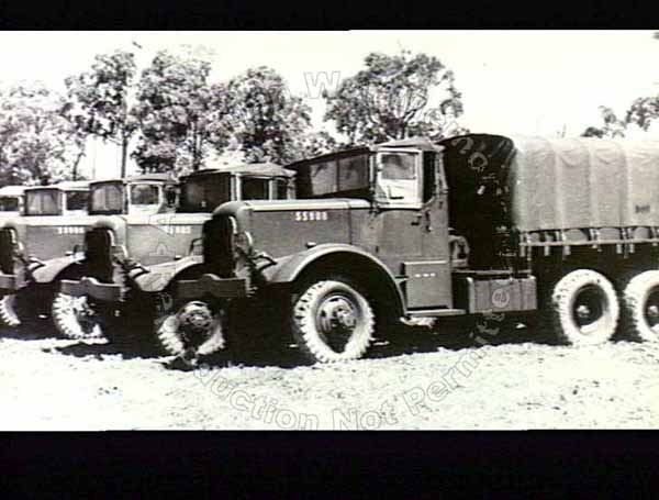

in 1943/44 the AIF received 400 of a diesel powered Mack to use on the North south supply route. This information is contained in 'Convoys up the track' by Alan Smith.
Attached are two pics from the AWM.
Does anyone have any info on whether any of these trucks still survive today?
Pic one
Old 11-08-04, 02:17
I am assuming that this is the same type but I could be wrong

Cliff, one of our club members has one of these Macks, but I don't know if it's an original North-South road one. I don't have photos handy, but I do have a video of a weekend away trip. Ill send it up to you.
Old 11-08-04, 11:14
Thanks for that Tony. I have also written to the Mack Museum in the USA to see if they have any more info on these as well.
I believe the top photo are the NR Mack trucks of the convoys and the lower photo is of AIF NO model macks.

Hi Cliff
These look like Mack NM-5 or -6 prime movers and quite a number survive in the UK,they were used by the British army and post war many ended up being used as snow ploughs or gritters.I though NM's were petrol engined though?
I used to have the 1942 TM for them but passed it on to a guy who was buying one to restore.
Old 11-08-04, 11:20
Matt thanks for that. You are probably right about the models. I am guessing but in Alan Smiths book he says they were 'Mack-Lanova' diesels. He also calls them 12 tonners and not the 7.5 ton of the NO's.

I can never remember the reference numbers, but the top photo is of a conventional Mack 6 x 4 like (Lucas, Lukas?) takes everwhere in Europe to all the shows. It's lovely but no ball of fire on the road, and could well be rated at 12 tons as it's pretty much just an on-road vehicle. Diesel, of course. Closed cab pre and post war, with open cab maybe 42-45 maybe just for the military? They have those cage-type wheels with detachable rims where you can change the rim but leave the hub and spokes on the axle while you do it.
The second shot is the numerically more common NM (maybe?) which as Matt pointed out used to push every snow-plow in Britian at one time. It was rated as a 4 ton 6 x 6 but that was off road so it was probably the equivalent of an 8 ton civilan chassis. they were originally petrol but I suppose a few got re-engined later.
Gordon
Gordon, in Scotland
Old 11-08-04, 13:09
gordon's Avatar
gordon gordon is offline
Location: Central Scotland
Posts: 708
Default NR versus NM
OK, so I went and looked it up.
Diesel top version is an NR, which came as NR6/8/9/10/11/12/13, if they are late enough to have open cabs they are probably NR9 or above. Mack - Lanova ED 519 cu in engine? 6 x 4, 10 or 12 ton.
The petrol-engined NM was a 6 ton 6 x 6 (why did I think 4?) and came as NM1/2/3/5/6 with the Mack EY petrol engine.
Gordon, in Scotland
Lucas Beaujon is a Dutch lorry driver and indeed takes his Mack NR everywhere. This picture shows his truck at Wings & Wheels 2002.
