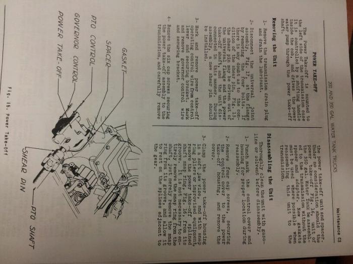

Do you have any photos of it? Also do you have this manual? Does this look like what you are seeing?

Hello
I dont have that manual. Is it available around?
Heres a picture of my shifter:
svenn
