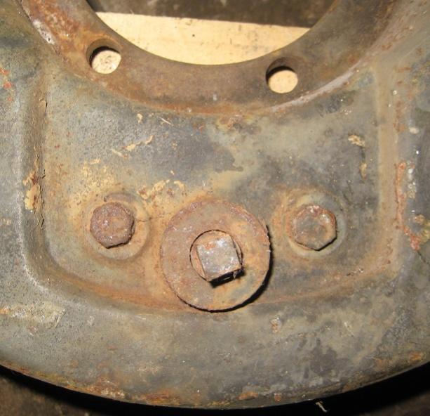

Thanks gang I used Common sense to Put the brakes together today and Judging from the Photos and links .I was dead Wrong. i had them Turned around backwards
Tanks I will reasemble tommorow

Brake assembly showing retracting springs on the shoes, hooked in so the body of the spring is between the web of the shoe and the brake carrier plate. Ref. E-4 of UC-F1.
The half round slots at one end of the shoes mounted on the adjuster plungers.
