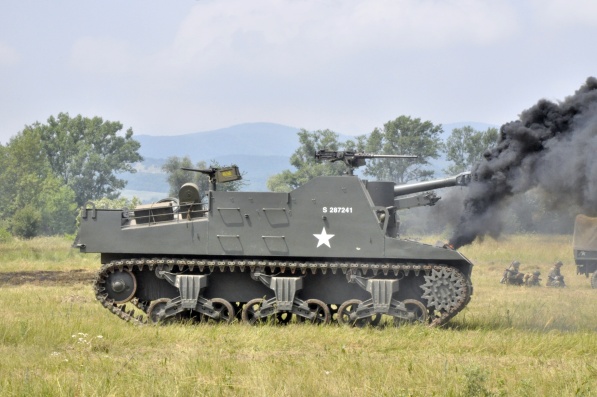

Hi all and thank you very much for all posts, sorry for my late reaction. Now the sexton starts on button, better than my modern car . I also attached pictures how it looks today and on one picture wah hit by german STUG III , brownings 0.50 cals are just for show, but i know that italians were using them with 105mm M4 howitzer.
The serial number is 1953.
