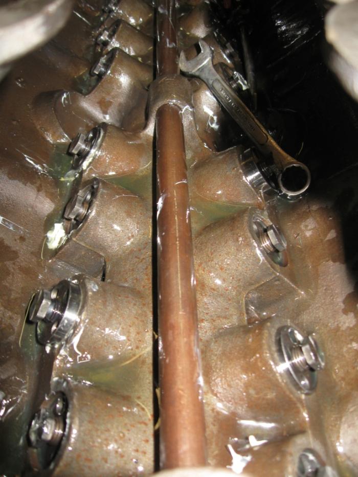

Today I commenced putting the valve assemblies in to the engine. Individually washed each valve and its items and then fitted the valve into the guide and checked it for free movement, installed the valve spring and with a bit of lube, placed it into its hole in the block.
With a screwdriver made sure the guide was down far enought so the keeper could be installed.
Then using the pry bar lifted the spring and fitted the bottom retainer.
Managed to get 6 out of 8 valves installed on the right side of the engine and 2 on the left (these were the ones where the lifted was all the way down).
This took me about 5-10min per valve. Remember, it's not a race.

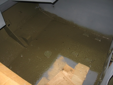

In the afternoon got sidetracked and painted the rear interior compartment, left hand side hull and the outer bottom right side of the hull. Not ideal painting conditions as the paint is still tacky after 3 hours.

  #118
Old 30-06-13, 14:00
Posts: 606
Default update on the last couple of days
With the parts that I had, I have finished the gearbox. It turned out that I did not have to weld the rear mount as I had the correct item on hand, so that is now bolted on. The output shaft willl have to be machined and sleeved as it has rust on the sealing surface from sitting all those years.
Painted the hull except for the front section of armour that has the new section of steel, that still requires work with body filler to get it flat. Hull looks good all green, bit glossy but that will change in the coming months.
Engine now has all valves installed and adjusted. I found that when you buy 'ädjustable lifters' what they really mean is that one must still follow the original method to adjust and insatll the valve assemblies, but the lifters are adjustable which speeds up and makes easier the installation. I thought with ádjustable lifters' that they would be more modern and be able to be adjusted in the engine much like my Chev or Jeep. Anyway that was 2 days well spent... I am now at the pint of installing the pistons, conrods and bearings.
I have painted the sump, intake manifold and carby choke/throttle bracket.
I also have a new carby from Mac's Auto and the other little items that I ordered have arrived.
Water pumps have been installed and that has allowed me to mount the engine into its stand so that I can work on the underside to install those bearings.
Found the original elec conduit from the front of the hull, so using that as a guide have welded in a replacement threaded block that secures the conduit into the hull.
Fitted 2 of the 3 oil cooler brackets.
Oil cooler valve and bracket installed into engine bay.
Work will slow down as I finish holidays and return to my normal job...

  #120
Old 15-07-13, 15:02
Posts: 606
Default weekend update
This weekend I continued (and finished) assembling the rings onto the pistons and placed all pistons & conrods into the bores. As I went checked all clearances on the bigend bearings and crankshaft journals.
Still very cold and had the blow heater going to keep myself and the rings warm.
Placed the oil pump into its location and tightened it up, book said to lock wire bolt in place, but with only 1 bolt not sure what to lock wire it to. So the lock wire now runs around the shaft of the oil pump, if it was to come loose it won't go too far (1/8 to 1/4 turn).
Cleaned out the sump of dust and debris and have front oil seal soaking in oil for when it gets assembled. In the front of the sump is a little 'receptacle' which is part of the PCV system, so cut some felt and placed in so that it will have semi-filtered air.
Installed all head studs on the left side with a little thread sealant so they will not leak water. Then installed the head and done up the head nuts. Not tight at this stage.
Also using copper head gaskets from the gasket kit.
Installed some new spark plugs into the head so that dust does not enter the cylinder, bought Champion H10-C from Repco @ AU$3.90 each.
I have the starter motor armatures at a friends being straightened as they are a little bit bent, with a bit of mild adjustment they should be right to be re-assembled later.
Also bought an air fitting for my die-grinder, so enlarged the hole in the left brake backing plate so that it now fits over the section of mounting plate where the brake actuator shaft goes through. Backing plate is now sitting on the diff, still to be done up.
My youngest son climbed up the ladder to study/check on my progress 'inside the hull, his comments were 'my you have done some work....."
Little bit more work yet before they can ride in it.
