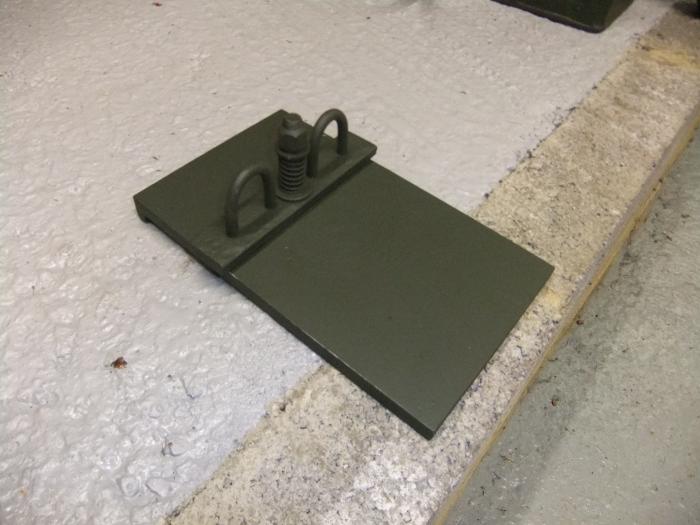

a while ago we get these plate.
i discovered it is tl947sa.plate,cover,loophole
try to fit it on our mk1,but it cant be fitted,i guess it only for a mk2.

Mine is a MK2, but I can't recall this plate? Where exactly does it fit please. Regards Ron

The FUC-03 illustrated parts catalog lists the cover as CTL 947 SA
for the carrier C31 UCW Welsh guards.
But it should fit any MK I or MK II??

it can be fitted in the gunners hole as a armor plate

Ah I realize what it is now. CTL 947 SA gunners slot cover plate. I have one, so no arm wrestling for it Mark. Mine is 3/8" (nearly 10mm) thick. Ron

The cover Roy shows has 6 rivets that project through the plate to form 6 stubby pins (just like my cover). What purpose do they serve - they don't seem to help position the cross-bar. The cover Ron shows does not have these pins. My original has no part numbers, unusual for a Carrier part. ...... Brian

i think ron his plate is a repro one,a Original plate is 7/16 thick.
the welded pins help to stay the crossbar in horizontal or vertical position.
our plate also don,t have the stamped number on it.
after esaerch i discovered that the platenumber is tl14115,plate and thecrossbar tl14116,bar locking .
the housing number for the stowage bracket is ctl 14120 housing,loophole,coverplate wich is fitted on a Welsh .
i don,t know there is a stowage bracket mounted on a mk2.

Correction! I have just measured my plate accurately with a vernier instead of the plastic rule I used yesterday. It is indeed 7/16". I've studied it with a mag glass and can't find a number. However the stowage holder which is mounted to the left of the firing slot, clearly has a part number. The top edge of my plate has an extra welded piece but no rivets....Could this be a British version? Ron

all the plates i have seen have the welded studs and the welded piece is on the edges rounded,also the other side from the plate has rounded edges.
the barlocking is also round grinded and the plate between the nut and spring sould be bigger,the nut is also welded on the bolt.

I have been discussing the gunner slot cover plate with Roy by email. He sent me a picture to show the rivets and their purpose. My plate has no rivets, but I just noticed that my front armour has two welded strips to form a rebate for the plate.
Is this a MK2 feature? Is a MK1 smooth?
Out of interest:-
My Candian parts list quotes CTL 947 SA Gunners slot cover plate
My British Chillwell list quotes TL 947 SA Loophole cover plate.

Here is Roys picture, bit fuzzy, but shows how the rivets/stubs keep it in place.

Gents, This I believe is a genuine loop hole protection plate fitted to a Welsh Guards Carrier.

Heres a couple of photo details from Ford of Canada showing the loophole cover plate in its stowed position and installed.

discovered more out
fuc-3 page 228 says ctl947sa is for c31ucw
illustrated parts list 1945 says: page h13
tl947sa is for universal mk2 and mk3
3 ich mortar mk2 and mk3
mmg mk2
also on page p13
tl14120 is only fitted in universal mk2 and mk3

it looks different ,on the lower side is a hinge,so you can lay it down on the front

found this pic from a mk1.
what plate do they have fitted in the gunport?
it cant be a mk2 plate,because that one is to width.

was thinking,could it be that the two welded strips to form a rebate for the cover a field modification is?
without the two strips it is possible that a bullet lift off the plate and make some damage inside the hull.maybee that,s why they weld the strips beside the cover.
