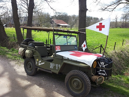

Old 27-04-20, 11:03
Posts: 14,977
Default restored Canadian ambulance jeep
Cleaning up my mailbox, I found this picture of a restored Canadian ambulance jeep, IIRC it belongs to Erik Nijenhuis:
