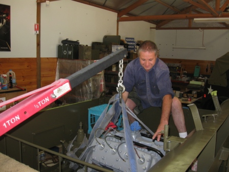

With the engine in and mounts done up, we then assembled the RHR seat and installed that into the hull for a test fitting. Little bit smaller than I remember when I was a child riding around in a friends BGC, I don't really have to worry as that is where the kids/friends will be as I will be in the front (hopefully driving it!).
Also installed the RHR suspension station into the hull, was going to use my floor crane to lift it, but with 2 people it was up and in within the minute. Then set about tightening up all the new fasteners. Still have to tighten the 2 engine rail bolts, but they are installed. It is now a little bit tighter with the engine in.
Removed the oil cooler and installed the better item.
Time for tea & sleep.
