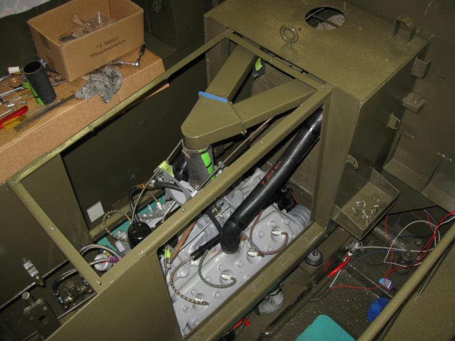

Little bit late with this update from the weekend, and like the new thumbnail size for the uploaded pics.
On the weekend I completed a number of little jobs and finished some tasks off, like the RHR suspension 2 engine rail bolts. My hands were too big and I didn't want to pull the starter motor off again, so my eldest son got down in the hull and, with assistance, installed the bolts & nuts and we did them up.
Another task, another son, we installed the painted oil cooler lines into the floor of the hull. Use some thread paste to seal the tapered fittings so that they do not leak later. Fitted the oil cooler lines through the air scoop slot and connected the lines to the cooler fittings. Next we installed the relief valve and positioned it onto its mounting bracket. As much as possible, I primed the cooler lines with oil.
Fitted the 2 saddle clamps that hold the oil lines to the engine rails, this presented a problem as the original holes may have been threaded and with
time and rust they are now holes. This required a longer bolt and a nylock nut, but to install the nut required small hands & arms to reach in under/around the engine and around the tube axle.
Interesting fact from the manual, to check the oil level the engine must be running when the oil level is checked. This is so that the oil cooler system is full and does not give a false reading and the operator has the incorrect oil level.
Utilised a thread tap to clean out the holes for the hull plates and installed the coolant drain hull plate.

Last week I dropped in to Vintage Wiring Harness at Ringwood, Melbourne and had a chat with Paul the owner. Very interesting what/how they do things there. Purchased some of the armoured coil for the rear wiring for the tail lights and some fabric braided wiring to go to my sender units on the engine.
On the weekend it was hot again, but I did connect the oil cooler and install the oil diversion plug (see pic), the metal braided hoses are connected. I did have to alter the plumbing slightly to accommodate my mechanical oil gauge on the back of the block/ oil supply side to the cooler.
I did fit a clutch rod and check the bends & angles in preparation for bending my clutch rod and fitting it.

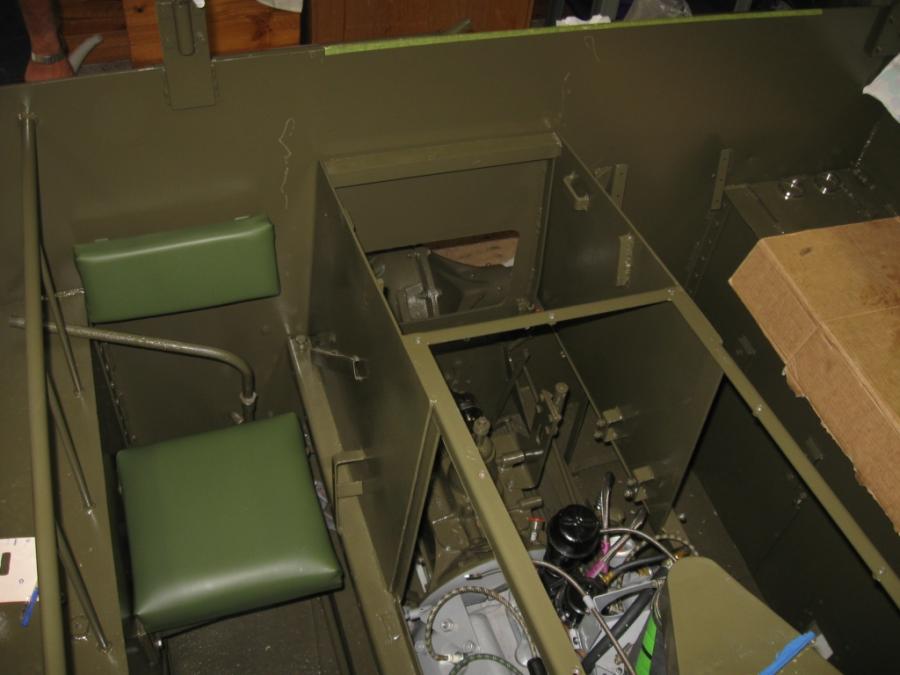

With Fridays good weather, I dropped the LHR suspension unit off to be sandblasted. This was collected later in the afternoon and undercoated. I was going to use the last of my green paint to give it a coat of colour, but the paint had gone solid.
Saturday- it rained all day.
Using Euan's clutch rods as samples (borrowed), I bent up my rod in the same style; however, my rod required its own unique bends to get it from the pivot linkage on the centre bulkhead to the clutch throw-out are/lever. This took about 2 hours of bending and test fitting to get right. It is in now.
I also cut and installed the leather grommet for the accelerator & clutch rod to pass through on the engine bay divider plate.
With the rods in, there was no excuse not to install the radiator. With my wife assisting, we lifted it over the hull side and down into position.
I did discover that the Macs Auto radiator mount kit, that I bought months ago, did not quite fit. The bolts are too short due to the extra thickness of the engine/radiator C channel rails in the hull. To over come this I got two bolts a little bit longer and drilled them for the split pins, otherwise the rest of the kit was usable.
Another point to note, I cut my clutch rods from the lengths listed in the parts book. These lengths are incorrect, I think they got the front & rear mixed up, Will find out for sure when I get to install the front clutch rod.

Default Monday's effort after Corowa
Took Monday off as a friend was down from Darwin and I was not too enthusiastic about returning to Melbourne. So, with little encouragement, we both worked in the hull and got some jobs done. Makes up for the small amount of work in the last 3 weeks.
We cut and installed all the radiator hoses and fitted new hose clamps. Use a smear of grease to assist in getting the hoses onto the radiator outlets and over the thermostat housings.
Installed the NOS choke & throttle cables into their correct positions, but discovered that the inner wire must be shortened and the linkage fittings shortened. Minor remediation work that can be done in the hull. The outer protective cover was a perfect fit.
The pics will give some idea, the 2 blokes are deep in thought about how it all goes together....

Installed the air induction tubes and bolted them together. Then read the parts book and measured the hose sections. Fitted the air cleaner hoses as per the parts book.
Read the parts book and assessed the hose section above the carby, we came to the realisation that this is a critical part as it may interfere when the engine cover is fitted.
So we then installed the engine cover (test fitting only) and measured & cut the hose section above the carby. This worked out to be 6 1/2" in length. Installed new hose clamps. There is not mush clearance between the air induction tubes and the engine cover.
Had problems with the hose section from the air induction tube to the LH air cleaner. After measuring the air cleaner bracket's position, discovered that the bracket was welded into the air scoop 1/2" lower than where it should have been and 4mm outboard. This meant that I had to cut a new section of hose to make it all fit and seal up.
With the RH seat fitted also did a test fitting of the seat with the engine cover fitted, quite tight, especially with the bracket welded onto the side of the cover near the dip stick tube/holder. This bracket digs into your LH hip joint.
I am still none the wiser about the purpose of this bracket, it may be a bracket for the rifle or bren MG stowage or to stow the 3"mortar bi-pod in the folded position. Anyone with a better idea......?
