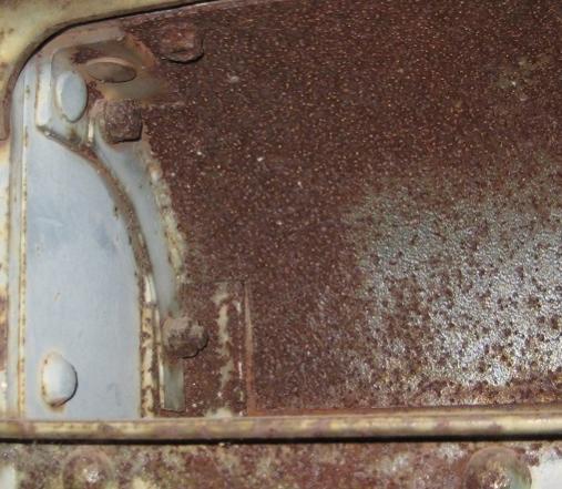

Rich, I think there is a piece welded into the curves at the end, so that a bolt (c/sunk screw or 2) can come in from the end of each air duct to hold it. if you follow.

Plate-engine ventilator deflector TL 7252 and fitting

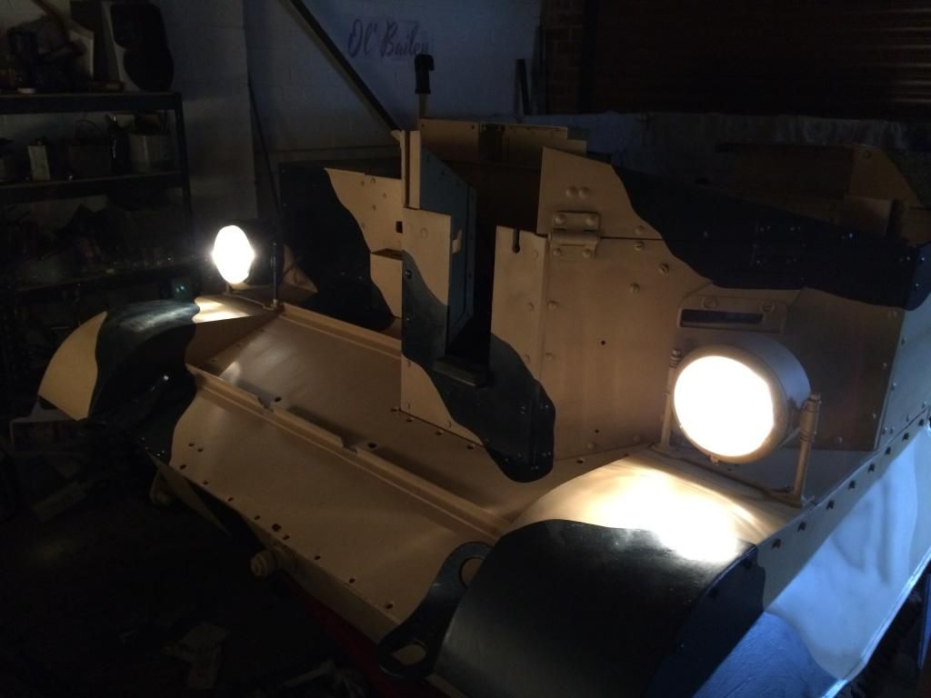

It has eyes !!!! And electric trickery !!!

show off
