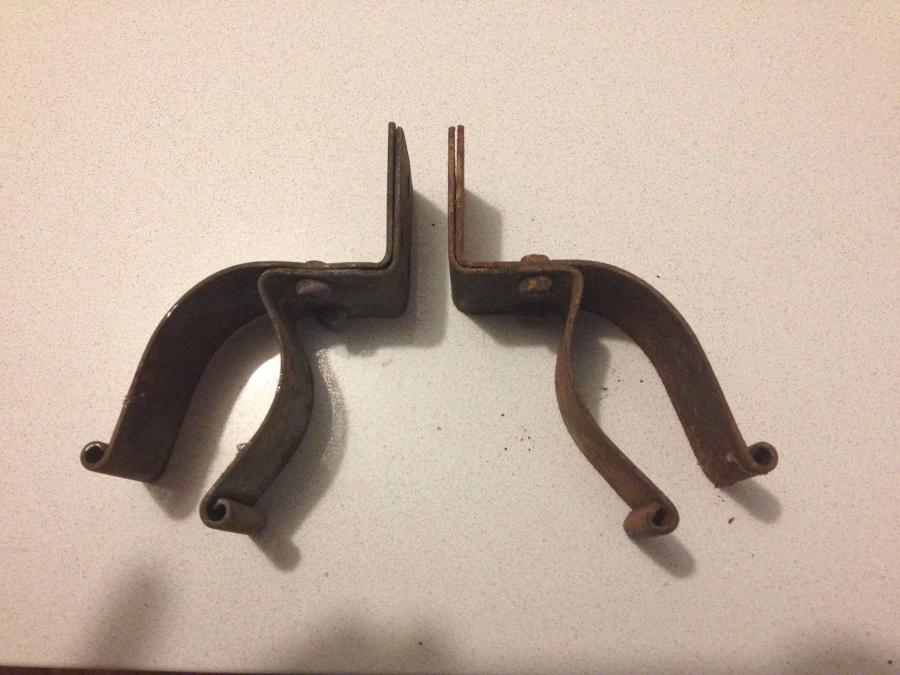

Hi Niels,
How are you going with your search for these? I have two originals that are sitting on my shelf and need to go to a good home.
They would have had leather covers as they are not plastic dipped.

Hi Phillip
Apart from the good advice on how to make them, not very well.
So I would be very interested your two clips
Cheers Niels

Hi Niels,
I've attached photos of the two clips for your perusal.
PM sent.
Phillip
