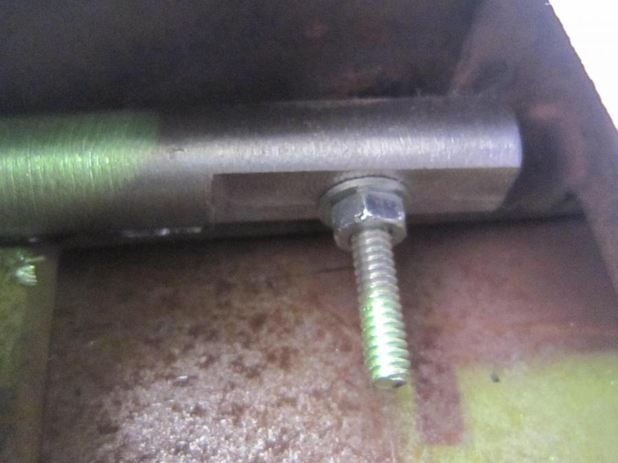

I also made the small pieces that fit and bolt to the top of the doors for the softskin windows.

Yes I know they are not "period bolts" so shane can change them if he wants to.
Shane' if you're watching you can pick your doors up and bring the clevis with you and I'll make pin while you wait.
