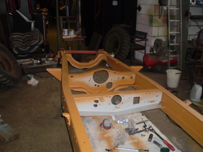

Posts: 17
Going back together .Nice to work with clean parts .Hope i can remember where they all go . T CORBIN
