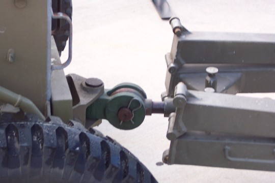

  #67
Old 24-10-04, 06:52
bubbaandshaff bubbaandshaff is offline
Join Date: Feb 2004
Location: FT Drum, NY
Posts: 37
Default Right Rear
View from the right rear. The towing arrangement with the NF&O Limber called for the guns towing lunette to be connected to the limber in a vertical position. It was then pinned together, similar to a bicycle chain.
Chris Shaffer

Hi there!
Tim the last few shots here are some of the ones i'll be sending to you buy will be higher resolution.
Phil...
