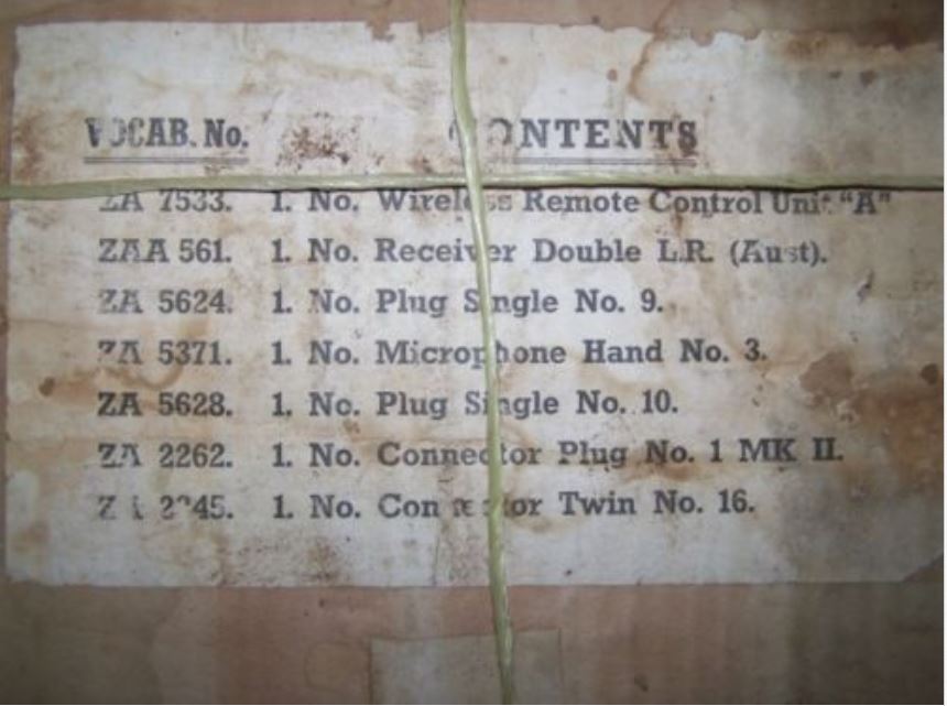

I got this Remote Unit A off Oz ebay. The build year is 1943 and the serial # is 17876. It was still in the original wrapping so was never issued and was likely one of the last ones made.
The general consensus was that Australian 11 sets were made into 1942 but this seems to stretch that by another year. 2 Unit A's were used per 11 set so there were enough of them for about 9000 radios. The Unit A's were used in ground stations and radio trucks but not in AFV's so we could probably add 5000 or so more radios in the 2 1/2 years of production. This would make for around 14000 Oz 11 sets. This seems rather high.
The remote unit is ZA7533 which is the British number so the Australians never redesigned them or most of the accessories.
This is being shipped by sea mail and expected delivery time is 4 to 6 months. They must be putting it in a rowboat!!

The remote units would be a lot faster to manufacture than the sets and the contracts were probably completed (or not cancelled in time) when the WS11 was declared obsolete and production ceased. Also, some remote units would be needed for training purposes, replacements, et cetera.
The great thing about your unopened unit is that you have all the ancillaries - which are very hard to find. (And people still insist that the shoulder strap with pouch is for a Very pistol, despite cast-iron evidence to the contrary.)

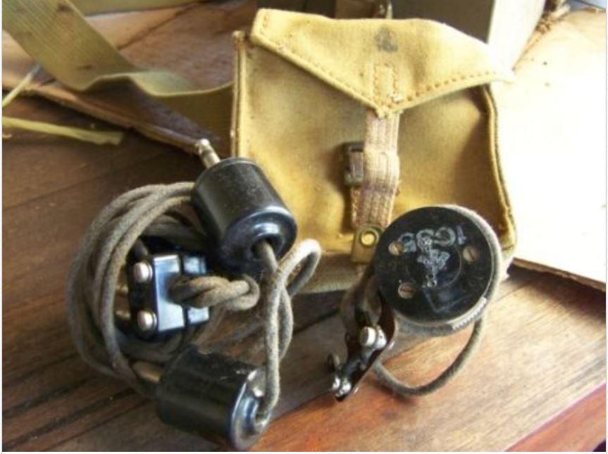

The counterpoise is a "multi purpose part" and was issued with a lot of radio sets that could be used as ground stations. It certainly appears in the WS19 Truck and Ground Station and the WS62 working instructions.
It's ZA.2784 Leads, Counterpoise, No.2 Mk.II
There are versions with bakelite (black) bobbins on the end, brown (ebonite) ones, and a later version with conical rubber ones moulded on, presumably to prevent snagging on things when being reeled back in.
Chris.

Old 04-02-15, 01:24
On the "erection of 11 set" video the bobbins are all missing and the wires are all a dark colour. This one mustn't have been used much to have shiny wires like that.
On ebay there are some from the Falklands war that have more and longer wires but are basically the same type thing.

According to Wireless for the Warrior Volume 2 (the appendices) there are Leads, Counterpoise, No.2, No.2A, and No.2 Mk.II so at some point there must have been a Mk.I, probably replacing the "earth mats" on early sets.
The Falklands era counterpoise has 8 radial wires and two cables with slotted lug connectors. This was issued with the "Larkspur" era kit (e.g. C11/R210) for use with the remote ATU; the longer cable would connect to the ATU earth terminal, the shorter cable to a "Pins, Earth, Small" - yes, still in use after 50+ years (though they cheapened the design a bit) -at the base of the 27-ft mast, and the 8 radials would be fanned out around it.
A later version still was issued with Clansman; this still has two lugged cables but the 8 radials end in heat shrunk sleeving and have short lengths of para cord so they can be pegged down easily.
Chris.
