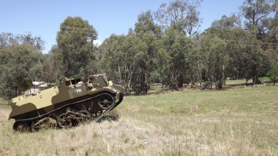

Our neighbour let us drive around on her 10 acre block/paddock, so after attending the local BBQ breakfast and flag raising, we drove down to the paddock (500m away).
With the size of the paddock and the laps that I completed, plus cutting back and forth; drove about 6km.
On 2 occasions, the engine stopped from fuel vaporising. Managed to restart the 1st time and continue driving. But the 2nd time I had to leave it for quite awhile and cool down. Spent the time in the neighbour's swimming pool. Not so bad.
Also managed to start finding all the gears, cannot get into 3rd and 4th around the driveway at home. But today I found them all!!!
BGC Jan 15 014.jpg   BGC Jan 15 028.jpg   BGC Jan 15 035.jpg   BGC Jan 15 039.jpg   BGC Jan 15 054.jpg

Great to see her out in her element, Darrin! Must have felt really good from your end!

Thanks David, it was good to get it out and run it without having to watch out for the house, carport/garage, dogs & garden beds.
The real challenge was driving on the road and keeping to the left (yes- in Australia we drive on the left) but not in the gutter. Luckily being the Australia Day public holiday there were no cars to share the road with.
I did try driving with the seat in the lowered position, but there was not much fun in that. Vision extremely limited and just an uncomfortable driving position. Much prefer the seat in the raised position.
Using my new laser temp gun, I had the following readings (curiosity factor):
wheel hubs 30-34deg C
brakes L 79deg C; R 70deg C
Engine (top of cylinder heads) 87deg C
Some of the suspension squeaks a little. Have since washed it so that may have fixed that.
Curious to know what others have done to stop their engines from causing the fuel to vaporise? modifications? heat insulation/wrapping?
This may warrant a thread in the carrier forum???

Posts: 606
Default a brief summary of our Corowa trip
I had a tilt tray load the BGC and deliver it to Corowa on Wednesday, I had to provide guidance on how best to secure it to the deck of the truck. The operator had never loaded anything like that before, and that was good, as he was open to advice.
Drove the Jeep across with trailer.
Camped at the Ball Park Caravan Pk in our usual spot. Parked the BGC out the front of our camp site.
It was good to catch up with several people on MLU at the park.
Thursday I went to start the BGC and the starter motor just spun. Pulled it out and discovered the bendix spring had shattered. Not good. A friend and I drove around town in his Jeep, looking for an engineering place that we could repair the spring. Instead, we found a place that the owner was into Ford hotrods and just happened to have a spare bendix spring at home. He was kind enough to loan me the spring to get me going. That got the BGC going again, and by lunch time we were driving along the river bank area.
On Thursday I managed to drive approx 35km until later in the day she was hot and vaporised the fuel system. This provided some quality time to talk BGC and reflect on BGC.
Friday morning I took it back down to the river bank area and drove around. Unfortunately, the BGC broke down again, this time it was catastrophic. The generator pulley had spun on the shaft and the fan bladed got wobbly. This was the noise that something was not quite right. Luckily the only damage was the pulley and generator. A friend brought his 6x6 GMC down and another loaned me a chain so we could recover it back to camp. I removed the blades and kept the cooling belts on, this allowed me to run the engine for a short period so that I could manoeuvre into our camp site.
Another friend in Albury had an engine with generator and pulley and was kind enough to loan it to me. So a 4hr round trip to borrow that, go home and clean & lubricate the bearings and return to Corowa, meant we had it operational again by 1700h. Just in time for the VMVC BBQ.
Friday night, attended the presentation by Mike Cecil at the football grounds. Sounds like there will be some good books coming out in the near future.
Saturday morning took the BGC for a quick test drive to ensure all was good. I still had some doubts about reliability and going in the street parade. last thing I wanted was to be broken down in the main street. All was good, so with the children in, drove up to the parking area and looked and all the other vehicles pulling in.
We drove the shorter version of the parade and headed out to the showgrounds. All went well, sat on approx 34-36 mph most of the way with the sound of the engine and the clatter of track on the road. Arrived at the show grounds and was parked in at the back. Not happy, as the other BGC there were all meant to be parked together off to the side. Oh well.
The swap meet was interesting. Didn't buy much at all, managed to talk with a few people.
My wife left early in the Jeep to go back to the park, this left my eldest son and I to take the BGC home. So when we could, we left. The BGC sat on 34-36mph again, all the way back. Went for a quick swim in the afternoon, it is hot work operating a BGC. Then later drove around some more until it got hot again. Then it started to lack a bit of power and not perform very well.
Saturday night, went out for tea with friends to a local restaurant.
Sunday, the day everyone hates, was pack up day. In the morning Keith Webb came by and we did an interview down by the river bank area. Packed up camp and had the tilt tray arrive at 1000h to load.
When we had it home, decided to take it for another drive in the vacant block behind out house. There we discovered what was causing the lack of power. The fuel tap and linkage had vibrated partially closed, staving the engine of fuel. Adjusted this and we were off again driving, until it got hot. Took some good quality pics and then took it home and gave the suspension a quick wash.
It was really good to catch up with people, especially those that are on MLU and meet those that helped me with info & advice. Thanks

Old 01-04-15, 13:53
Posts: 606
And a BIG thanks to Ian for assisting my wife and the Jeep, as it also had issues.
A bolt on the bendix spring came loose and jammed the starter, while trying to start it, this then drained the battery of life. The starter motor got quite hot.
I got 6 years out of that battery...not too bad.
Had to pull the starter out and put bolt back in. All good now.
