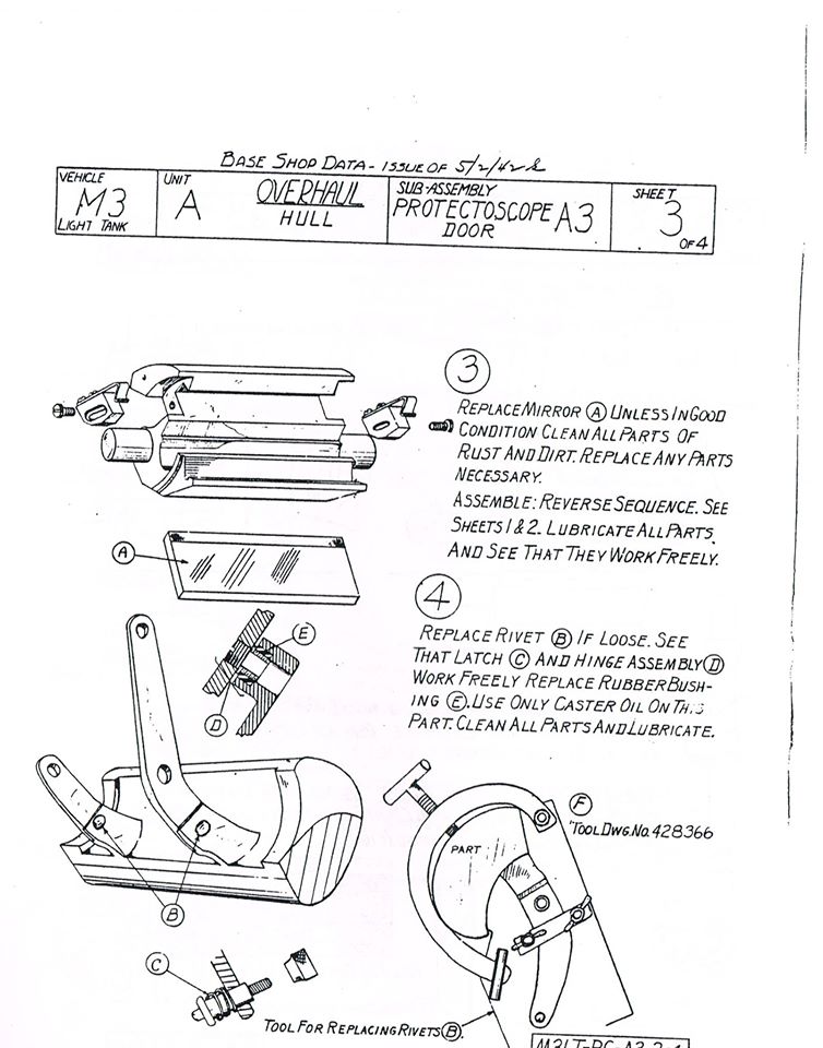

I am in the process of making protectorscopes for the Stuart.
Have done the pistol port ones and most of the two Forward door bits.
I have drawings and have cast up the prisms for both.

Gina; In your figure sheet 2 of 4, is item A, "glass". I am pretty sure this is an item that have NOS: mine are plexiglass, 5-7/8" long, 3/4" thick, maximum width 2-1/4" with the polished faces being 1-5/8" x 5-7/8". They are different than the glass pieces that you posted earlier in photographs. PM me for more info or with an email where I can send you a photo.
