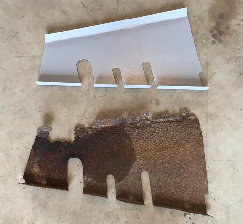

Guys,

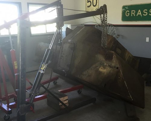

With the engine in limbo, decided to move onto the hull. The floor needs some welding repairs before I haul it off for sandblasting and primer. Rotated the hull so that I can clean and prep the area before tracking down a welder.
The cost of rebuilding the original engine escalated to the point where I am trying to track down a more cost effective 239 engine. Some promising leads. Wish me luck, Peter
Name:	2015-08-24 12.41.02.jpg
ID:	75858 Click image for larger version
Name:	2015-08-24 15.22.14.jpg
ID:	75859 Click image for larger version
Name:	2015-08-24 16.26.15.jpg

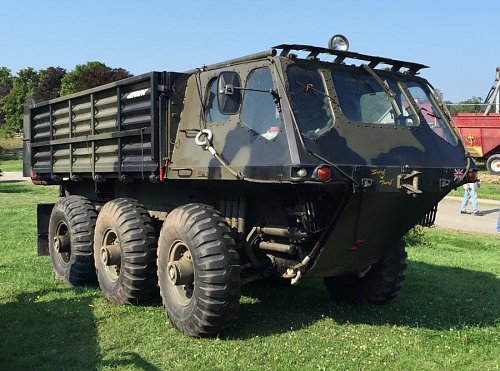

  #213
Old 08-09-15, 05:31
Robin Craig's Avatar
Posts: 2,164
Can anyone pass the details of the Stalwart owner along, PM is fine.
Another owner is asking
R
  #214
Old 10-09-15, 06:26
Jon Bradshaw's Avatar
Join Date: Jan 2009
Posts: 270
Default I like that first one.
Brian's creation is a great example of building something from something else. I just wonder what it was based on? Or was it just something he cooked up?
Either way I would love to see it at Odessa next year so I can take a look.

  #217
Old 12-09-15, 19:54
Join Date: Jan 2009
Posts: 270
Default Nice work
I thought with the wheels it could have been a half scale British Tetrarch.

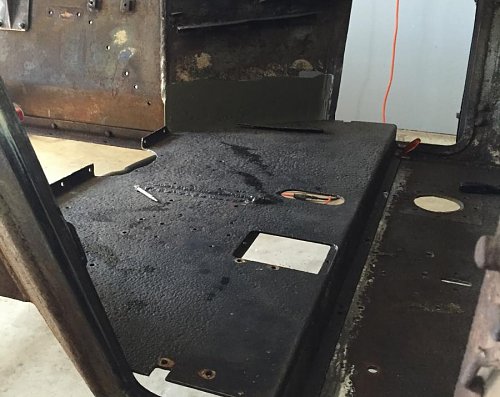

Default Finally
Folks,

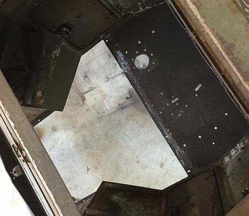

This restoration trip seems to consist of two steps forward, and one step back. Quite rewarding when I finally reach one of my goals on this journey.
The hull floor is now all welded together and all the cuts that were done when the Lynx was cut in half have been restored. Feels quite good.
To add to the subject of paint, I have yet to find any evidence of primer being applied when the Lynx was first painted. Since we are only temporary custodians of our old iron, I have decided to use a two part epoxy primer.
I have been enjoying the conversations that started since I posted the picture of Brian Asbury's creation. I hope that Jon will now post some pictures of his replica.
Peter
Name:	2015-09-12 13.44.32.jpg
ID:	76167 Click image for larger version
Name:	2015-09-12 13.51.35.jpg

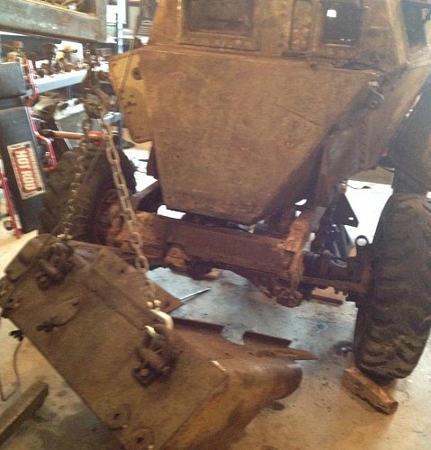

  #224
Old 29-09-15, 02:56
Join Date: Apr 2011
Location: Cherry Valley, ON
Posts: 554
Default Road trip

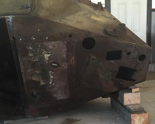

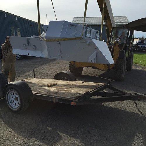

Finally got all the little bits and pieces repaired/fixed/replaced in the hull to the point where it was ready for sandblasting and epoxy primer.
Loaded up the hull and transported it off to Darren Green's sandblasting in Desoronto. With luck on it's return it will be mounted on the frame.
Name:	2015-09-28 13.24.27.jpg
ID:	76503 Click image for larger version
Name:	2015-09-28 14.45.49.jpg

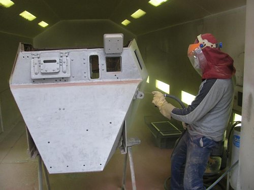

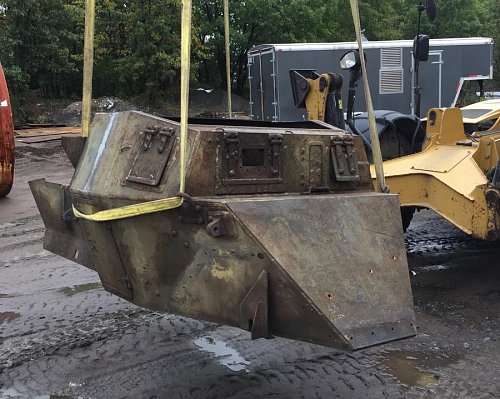

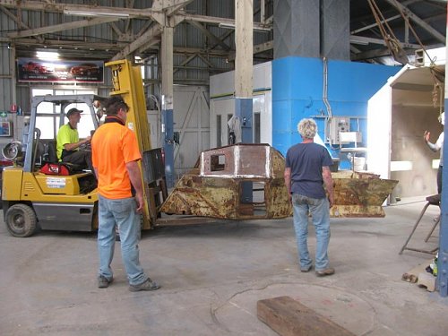

  #225
Old 29-09-15, 11:02
lynx42 lynx42 is online now

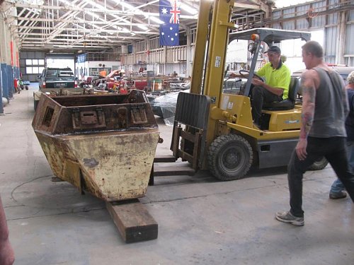

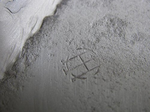

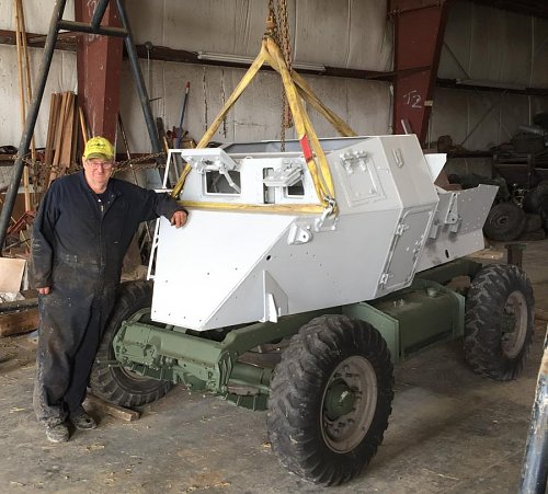

Looking good, Peter. Here is mine being placed into the sand blasting booth.
Name:	Lynx SandblastHull 110.jpg
ID:	76511 Click image for larger version
Name:	Lynx SandblastHull 113.jpg
ID:	76512 Click image for larger version
Name:	Benambra Display 033.jpg
Look out for the IHC stamp just in front of the windscreen on the right side of the flat or horizontal plate.
Name:	Lynx Start to Finish 024.jpg
Regards Rick.

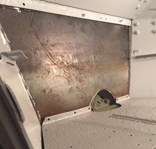

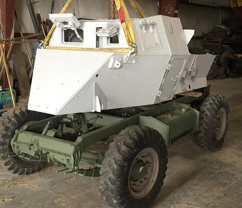

  #226
Old 06-10-15, 04:46
Join Date: Apr 2011
Posts: 554
Default Another milestone
Guys,

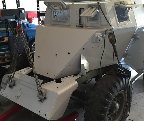

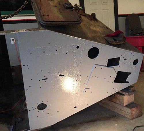

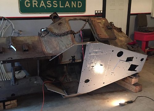

Got the Lynx back from sandblasting and primer, quite pleased with how it turned out. Living in a very rural spot, I am quite fortunate with my neighbours. The Rankin family, have a large farm, and also a great shop with a handy gantry. It made putting the Lynx together a much easier and safe task. Bob Awder, their mechanic, also ensured that I left with all my digits intact.
Great feeling once it was back in the garage to realize that it's the first time in decades that it's now back in one piece. Peter
Name:	2015-10-02 09.47.52.jpg
ID:	76635 Click image for larger version
Name:	2015-10-05 11.40.44.jpg
ID:	76636 Click image for larger version
Name:	2015-10-05 12.04.55.jpg

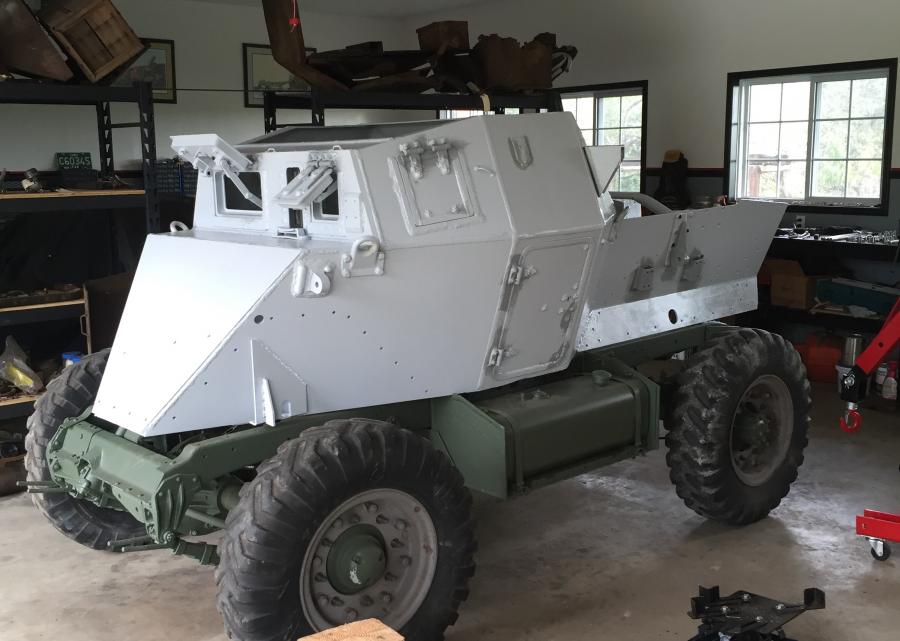

ID:	76637 Click image for larger version
Name:	2015-10-05 14.05.52.jpg
ID:	76638 Click image for larger version
Name:	2014-03-15 12.16.30 (2).jpg
  #227
Old 06-10-15, 12:13
Posts: 2,769
Peter,
Wonderfull work! I think in the automotive industry mating the body to the chassis and running gear is known as the "marriage".
Keep up the good work.
  #228
Old 06-10-15, 15:06
RichCam's Avatar
RichCam RichCam is offline
Location: Huntsville, Ontario
Posts: 347
Default Over the hump!
Congrats Peter! You are now over the hump and once you get the engine back in, then the fun starts! Keep up the great work! Cheers!
Richard Hatkoski
1940 CMP C11 C-8 (Restoring)
1940 CMP C11 F-15A (Parts)
1941 CMP C12 C-15A (Parts)
194? CMP C13 C-60X (For Sale)
  #229
Old 07-10-15, 01:27
Going well Peter, Almost a pity that you have to remove it again to fit the engine etc.
Did you find the IHC stamp?
This photo shows the International Harvester built Lynx Mk.I hulls being married to the Ford chassis. They are very complete before fitting to the chassis.
Regards Rick.
  #230

Rick, no luck with the International Harvester stamp, in front of the drivers vision port, on the horizontal glacis plate. I did find a second stamp of the hull number 4225, and what appears to be the remnants of an arrow.
With regards to removing the hull again, I'm hoping that with the transmission, transfer case, shifter linkage and drive train already in place, that I can mount the engine with the hull in place. The gas lines may pose a bit of a challenge.

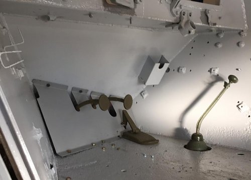

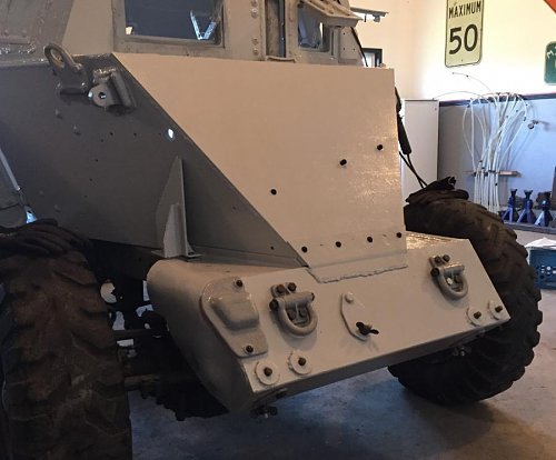

Latest,

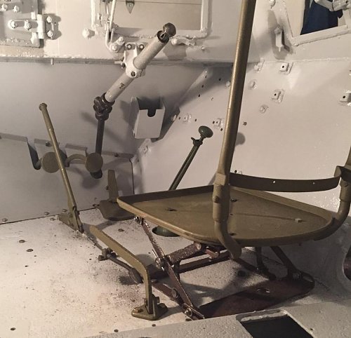

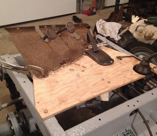

Got lost on the way to the firewall and ended up working on the drivers controls. Installed a new toe plate, the original was only good for a template. Takes a bit longer bit longer but its nice to be adding parts. Cleaned up the nose armour and with some luck it will be off for sandblasting and epoxy priming tomorrow.
Name:	2015-02-20 19.58.42 (2).jpg
ID:	76815 Click image for larger version
Name:	2015-10-07 15.46.14.jpg
ID:	76816 Click image for larger version
Name:	2015-10-10 08.51.19.jpg
Peter, You will find that you have to remove the new toe plate again as the four nose armour bolts are behind it and you cannot tighten them up with the toe plate in place. It is also hard to fit the toe plate if the front locker is in place, so watch out for that too.
Regards Rick.

Default Right
Rick,
Just wish that you lived close enough where we could share a few drinks while talking "lynx". You are right about the toe plate, it'll have to come off for the nose armour and also for the steering column. Couldn't resist, its just too rewarding to be adding parts, instead of disassembling components.
Didn't consider the front storage bin. The one for my Lynx is completely missing, only found remnants of the supporting braces under the front tow hooks. My current plan is to get the Lynx up and running before tackling a new storage bin. The observers seat also falls in this category.
I appreciate your comments, please keep them coming. Peter

Made it to the Acton swap meet and Christmas came early, thanks to Ross and Brian.
Fitted the nose cone/armour to the Lynx, now starting to resemble the real thing. All in all, a great week.
Peter

Default Shrinking
Folks,

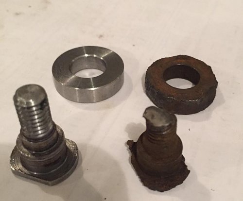

My friendly machinist did a great job of fabricating new shoulder bolts for the drivers seat mechanism. Dry fitted the drivers seat and put together the steering column and started on a new firewall. Of course I then had to try out the drivers position and found myself in the same predicament as Bob Carriere, and his Cab 11. It makes for a tight fit. Definitely manageable, but it is snug.

They grew fellas small 70 years ago! I think the average height then was about 5'6" and about 150lbs

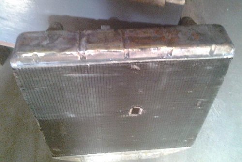

Default Radiator
Guys,
With my limited mechanical skills, I've been very fortunate to find some very talented craftsman while tackling this restoration. Don Graham specializes in restoring antique and custom radiators, out of his shop in Frankford. Not only did he manage to restore and repair my old radiator, but he did it for far less than I had planned for.
