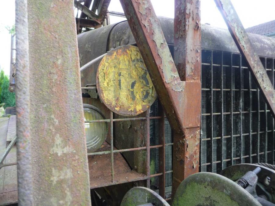

Since one week we have rescued a (now) very rare BROCKWAY QUICK WAY. From our knowledge only one is in running state in GREAT BRITAIN and an other in USA
There is an other in FRANCE owned by a private military vehicle collector.
Our truck was in a famous scrap yard in the south east of FRANCE near the little town of ROMAN in the DROME country.
A big lot of work is waiting for us but the truck has no missing parts. On the pic we can see the CLASSIFICATION BRIDGE with the number 18
Regards Serge

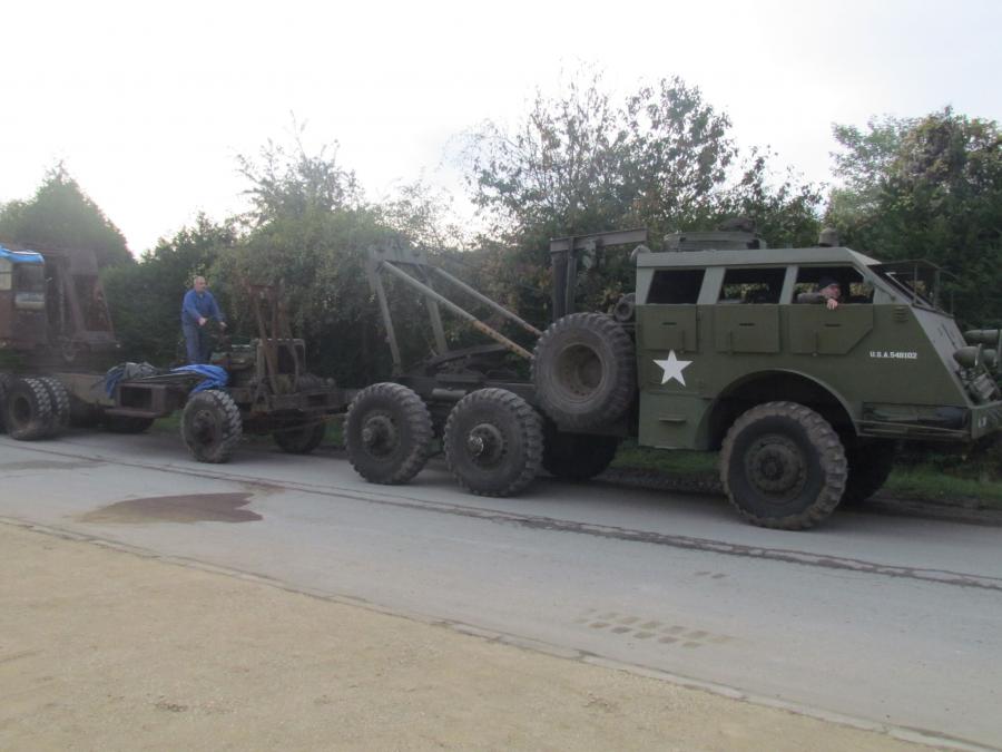

To day , our problem is to put the truck in our shed but when the BROACKWAY was trailed by our PACIFIC M26 the first rear wheel stayed blocked and after 100 mètres the wheel shaft broke. Even without these part the wheel can not turn and I expect that the reason is rust between the drum and the rabestos.
Regards Serge

Using our one of PACIFIC M26 the BROACKWAY has been towed the pushed in a safe place.
Some pics joined
