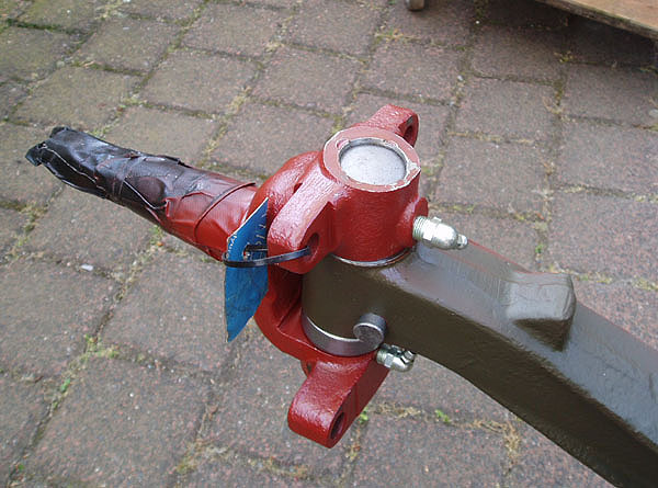

Next up was fitting the front suspention with some new bushings, pins and bearings. I was lucky enough to find a new set here in Holland. Removing
the old bushings and fitting the new ones was an easy job with help of the vise and a 19mm socket.
Afterwards the bushings had to be reamed to the correct size to accept the kingpin. The blades on my reamer were too short to work on both bushings at the same time....in other words there was a risk the surfaces of both ends would not end up inline, but at a slight angle. To solve this I made some plastic bushings on a CNC mill that would fit just around the shaft of the reamer and would just fit inside the bushing. I was quite happy with the result as the kingpins fitted perfectly after the reaming was done.

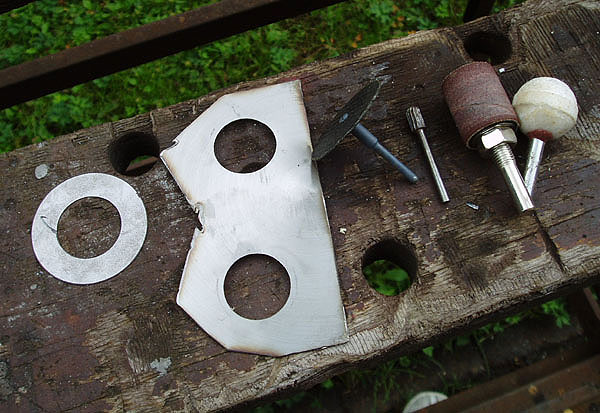

The kingpin set did come with some shims, but sadly not the sizes I needed to get both pins within spec. I tried to find some extra shims here in Holland, but didn't have much luck in finding the correct diameters.I tried to have a few made, but the trouble was that I wasn't able to find anyone who was willing to make just a few....as they had to buy a whole sheet of material just for this job.
I did find a set of correct shims at Speedway motors in the US, but I was impatient, so I didn't want to wait to loose days to transport...So, in the end I visited the local department store and bought the first cheap stainless China product I could find that had a flat surface big enough to make a few shims. I think it was some crappy dinner tray.....but after some work with a Dremel tool, it's now part of my Front suspension.
I am very happy how it all turned out...all within spec.

Niels,
I bought my kingpin set (bushings, pins, lockpin, dustcover, shims) from Prins truck parts here in Holland, (www.prinstruckshop.nl). I have just checked the bill and it's listed as "1947-1952 3/4ton + 1 ton" "order nr.39-208-1". I think I recently checked for Jacek...and C15 is different from C8.
Kingpin sets are also regularly for sale in Ebay, new as well as NOS.
usally, the reamer has a long pilot that screws onto the end of the reamer and guides the reamer as it goes through the bush.
Mike, hmm....I inherited a bunch of different reamers from my late father in law...I think they hadn't been used for a very long time and I think that pilot went missing a long time ago

Phil, I quite like the idea of those specialised repair trucks. I have also seen mobile sand blasting in action and have also heard about allow wheel repair trucks, mobile dent repair and paint shops.
Neat idea using the dremel to make the spacers
Mike, it was quite easy to make the shims with the (fake) dremel and some simple tools. I just made sure to clamp the stainless to the workbench, as rotating tools and thin sheet metal can make a real mess.

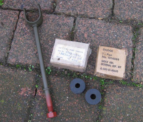

The filling station sleeved my second master cylinder (thanks again Guido) and also supplied new U-bolts for the front axle. The correct size for the C8 was not available from stock, but they made a set of slightly longer bolts for just a few dollars extra.
This time with the master cylinder I cleaned all threads thoroughly and installed the cylinder after marking the studs with a white line.....just to make sure the studs wouldn't turn while securing the nuts (studs secured by hand this time and secured with some Lock tite).
The shock links were far gone. I tried finding replacements, but didn't have much luck.

I decided to re-use the C-shaped end that fits around the arm of the shock absorber, and have some new rods made up. The local machine shop made new ones for the front and back of the truck. I drilled a hole in the "C" and made sure the new rods would protrude about half an inch. Both pieces were than welded together.
Dirk at LWD has the proper NOS rubber bushings and retainers available (in the Ford section) for the axle end of the rod.
I bought a Dodge WC set from Jeepest in France for the other end, which supplied pin/bolt, nut and a new steel bushing for the rubber bushing in the end of the shock arm. I had already replaced the latter with new rubber bushings bought at a militaria fair (also Dodge WC I believe)....put the rubber in boiling water, hoping this would make the rubber softer and easier to fit....didn't really help....some grease did!

Have you considered cutting the rusted part of your link rods and welding a grade 8 fine thread bolt of suitable lenght?
I sharpened the old rod and the bolt to a pencil shape...... used a section of 1 inch angle to insure line up of both rods.... just set the rods in the vee .
If you cut out a small window in a 12 inch angle iron section the rods will line up and the window will give you access to weld..... easy with a mig...... grind off any excess after and you done.
cheers

I actually bought some shock link rods from Vintage Power Wagon knowing they were too short.
I used the upper protion of the original link from my cab 11 and cut/welded/grafted the bottom threaded portion of the new link rod....it gave me the ring and rubber bushings, cupped washers, new thread section and the whole thing looks like new. Also did another set just using long grade 8 bolts but needed to find the necessary fine thread and tack welded the cupped washer where the ring would have been.
