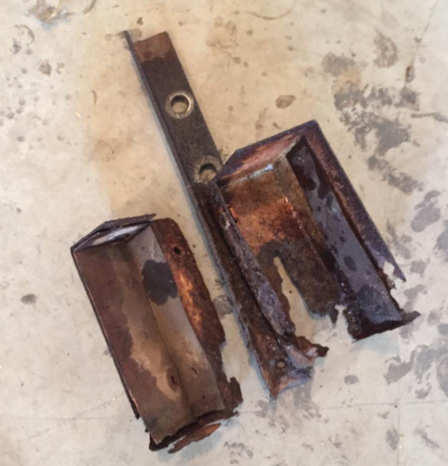

Guys,
Typical of this restoration it's a mixture of new and old. The ends, bottom and back are original while the front and top is new. Nice to move on from the cardboard template.
Peter

  #300
Old 13-03-16, 23:06
Join Date: Apr 2011
Location: Cherry Valley, ON
Posts: 554
Default British content
Guys,
To date all the components for the Lynx have been of Canadian or American manufacture. That is about to change. I had taken one of the last electrical components - wire fuse and holder, C19SR 14525 to the OMVA meet in Acton, to try and find one. No luck, but folks suggested that I goggle SLYDOK and see what was out there. Thanks Colin and Charlie. Up popped The Fuse Company in England. Will have to wait until I can talk to a real person tomorrow, but it looks as if they still carry them. The fuse looks like a more modern one, but this could be one of the last pieces of the electrical puzzle.
Was great to attend the swap meet and reconnect with folks and have some faces and personalities to place with email connections. Belonging to MLU and OMVA have allowed me to meet a lot of great people.
Peter
Name:	2016-03-13 01.30.49.jpg
ID:	80429 Click image for larger version
Name:	2016-03-12 16.58.08.jpg
