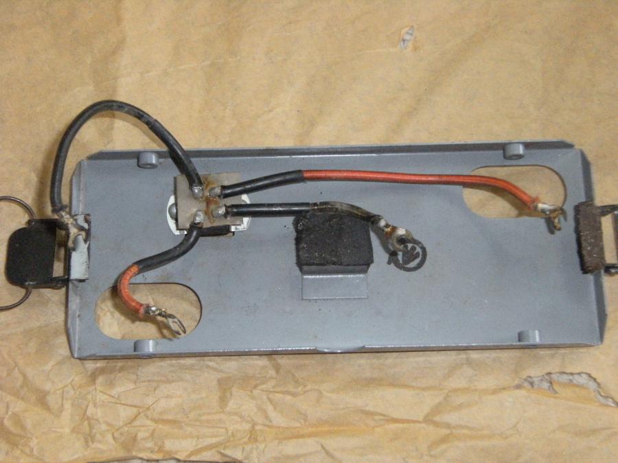

I purchased the one on ebay and am trying to more or less restore it.
I have patched up the holes and made a new fuseholder and installed a battery switch and plug.
I am now trying to figure out what the "C" battery holder looks like.
Does anyone have a picture of this? Was the 21 volt battery special or a commercial one? (I have seen 22 1/2 volt photoflash units which look to be about the correct size.)
Also, does anyone know who made the headset/mic plugs?
George

Default Ws-58 vpu
Pics of the VPU
The system laid out
The c battery holder
Accumulator connections
10 pin Jones plug which has both headsets and power to the radio
4 pin Jones plug at bottom of VPU to accumulators.
The headset plugs are Cannon 4 pin microphone connectors Pt. # 4-11
